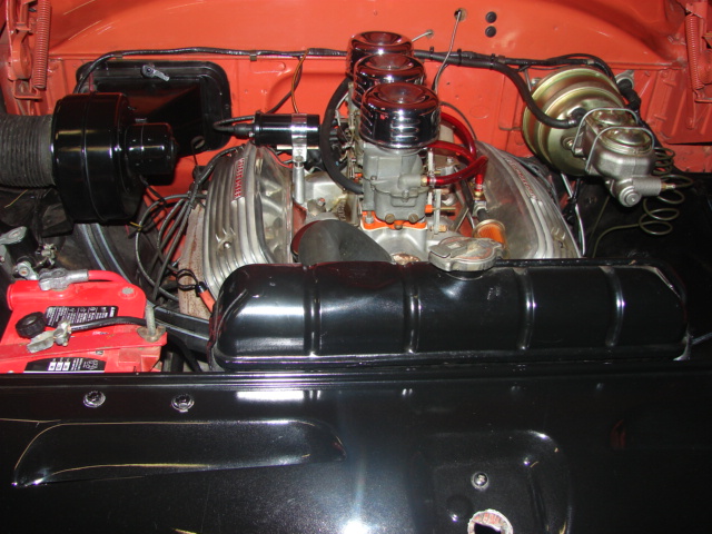

http://forums.y-blocksforever.com/uploads/images/fdbc2710-7317-47ca-98ed-6828.jpg
Here is a picture of my "272" dressed up.  I blocked off the front & back carbs , I have been to a few big car shows & display it with the hood a quarter of the way up & it really draws interest & none of the gearheads have ever noticed that the linkage only operates the center 2 barrel.........

Double check the cylinder head casting numbers.  The cylinder heads will dictate what you can do in regards to using other intake manifolds.  Beyond that, all Y-Block valve covers are interchangeable.
