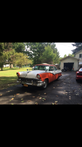

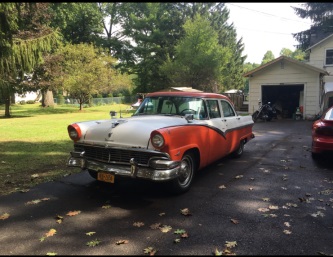

Hello, I have the original vacuum wiper system and really want to convert to a 12 volt kit ; anyone have any recommendations where to get one ? The car is a 1956 ford Fairlane town sedan 4 door . Appreciate any help/ direction anyone can point me in !
