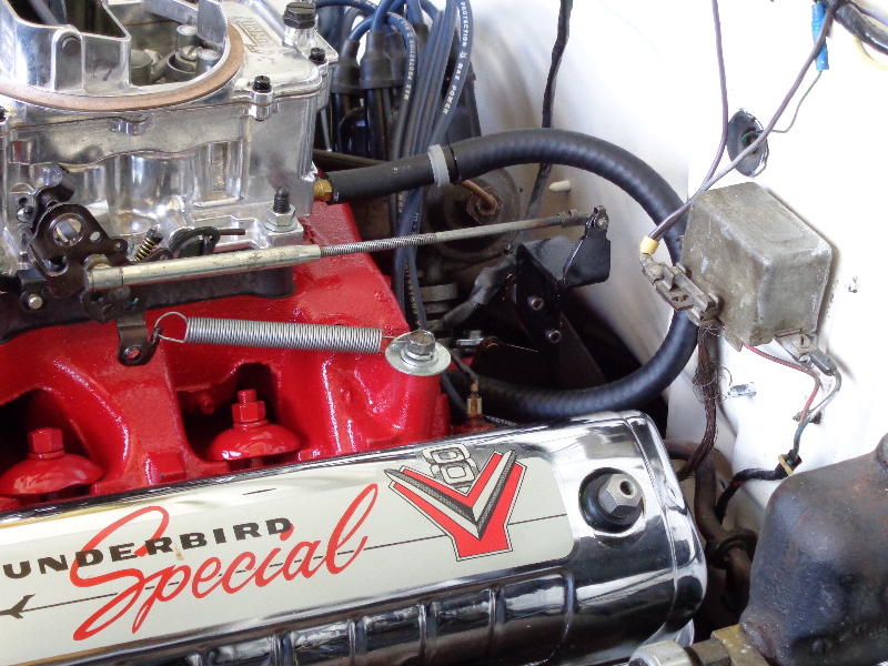

You don’t mention what transmission you have which is a player when working with the accelerator linkage.  Here’s a picture of what I’ve done to both a ’56 Ford and my own ’55.  Both had standard transmissions.  If you're dealing with an automatic transmission and its associated kick down lever, then I don't have a picture of that.
http://forums.y-blocksforever.com/uploads/images/98b254cd-6461-41f4-9fe3-b7f0.jpg

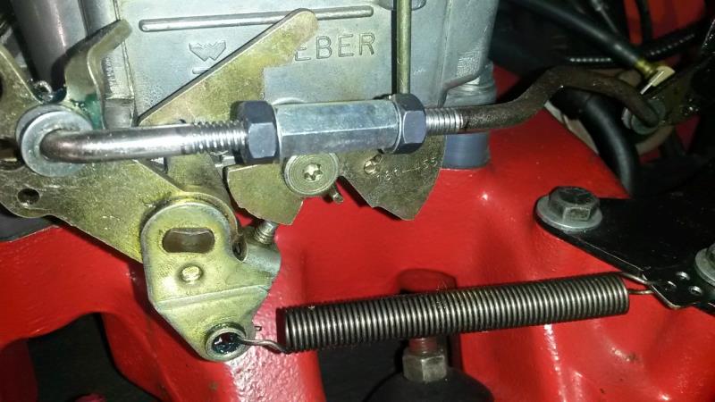

http://forums.y-blocksforever.com/uploads/images/32114245-a5a4-4c0a-b545-4088.jpg        You may have to make one .. I had to knock this up.
