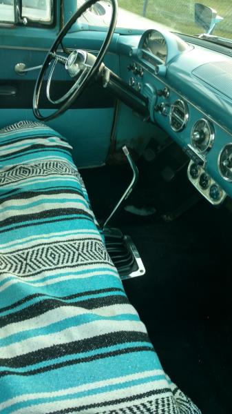

Rono, if you are using a bench seat, can you post a pic of where the shifter sits? Doing the swap in my 55 CV soon and looking around for a shifter. Thanks
Rowen
Rowen
55CV
Woodland, Ca
Rono
Posts: 1.3K, Visits: 80.0K
Rowen;
Not using the stock bench seat. Changed to Wise Guys buckets.
