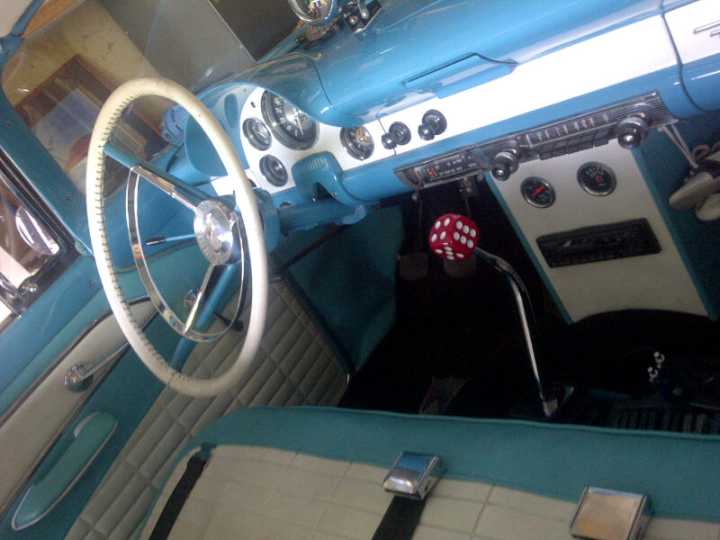

Rono, if you are using a bench seat, can you post a pic of where the shifter sits? Doing the swap in my 55 CV soon and looking around for a shifter. Thanks Rowen
By Rono - 8 Years Ago
Rowen;
Not using the stock bench seat. Changed to Wise Guys buckets.
Rono

Like I said, my car is a daily driver work in progress so forgive the ratty interior. It'll be nice one day. I chose to use a shifter from summit. It's a generic summit brand billet shifter for mustang T5 for about $140. It may be Chinese, I don't know, the box says made in USA and it looks like a quality product. The reason I chose it is because it had adjustable stops. I didn't order a shift handle until I'd finished the job because I wasn't sure where it was going to come up through the floor. I didn't want a potentially long shift handle applying excessive pressure on the forks and wearing them out prematurely. So, once I saw where the handle came out I got on the Core shifters website and ordered the Hurst shifter handle I liked which bolts right up. In the pic I have the stock bench seat in the rearmost position and the shifter is in neutral. I'm 6'1” so my seat is staying there haha. Looking at it now with the shift handle I got, I think it might be for a truck but I'm happy with it. I don't think it looks rat roddish (which I hate). I can shift through all the gears while sitting upright and no leaning forward for the upper gears. Plus once it's in 5th I still have room for a female to sit close. Now that I have done this setup, I don't feel that the shifter with adjustable stops was quite so necessary. Especially if you're going to use a shorter stick.

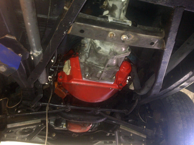

Forgot to include a pic of the crossmember installed. Crude pic, I don't have a lift yet so undercar pics are tricky.

Nice job on the crossmember. The only thing I'd do differently is put the bolt holes on the side opposite the tubing weld seam.  If you have not already, smooth that seam so that the washers and bolts clamp properly.
By fastbillsgarage - 8 Years Ago
Charlie you're a sharp fella to catch that! hahahah. I agree with you and I caught that during the build process. the black one in the car has the seam on the right side, the bare metal one is the model to duplicate from. good catch sir!
