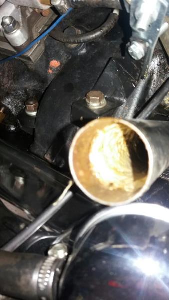

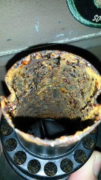

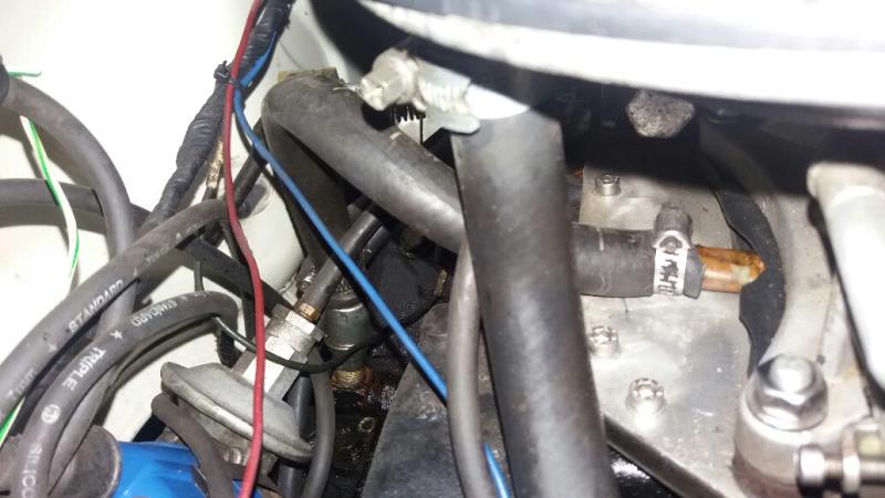

Hi Paul,
good question. The vent seems to be ok. All tubes and hoses are free. For details see pics.
Oil fill cap to aircleaner
Pcf to intake /carb
View into oil fill tube
My dirty oil finger
