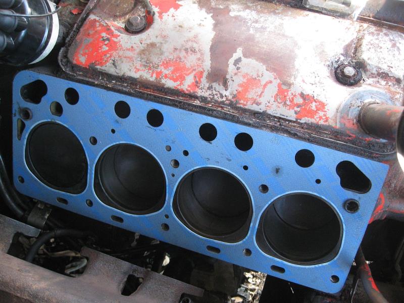

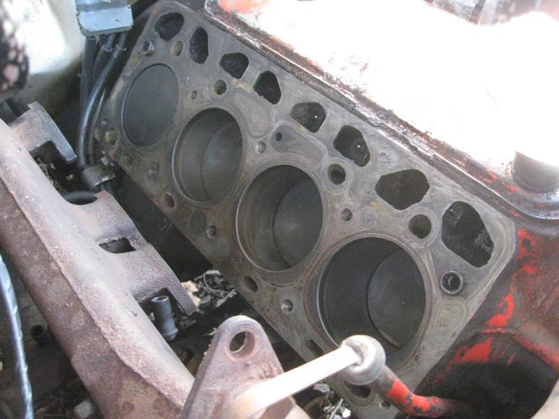

The little tab, if we're talking about the same tab, is sticking out of the top front corner on the passenger-side head. I took quite a while looking at and comparing the old and the new gasket to see if the holes matched up and if any holes in the old gasket were covered in the new gasket. I put some pictures up of the bare block with no gasket, and it with the gasket put on. Something kind of that stands out to me looking at it now, there are two channels on the bottom corners near the bolt holes that look like water passages. But on ever gasket I can find online and on mine I have installed, they're covered up. Man I really wish I had the old gasket still or a picture of it to double check. But surely that can't be a design flaw in the gasket!
http://forums.y-blocksforever.com/uploads/images/d8bc9ca4-d23d-4b72-b81a-4f74.jpg
http://forums.y-blocksforever.com/uploads/images/a1d65a34-3860-4553-8700-260c.jpg

It does sound like you have checked most items.
RE the passenger side head gasket, where is the square corner of the gasket positioned?  Even though you didn't change the other, how is it positioned?
