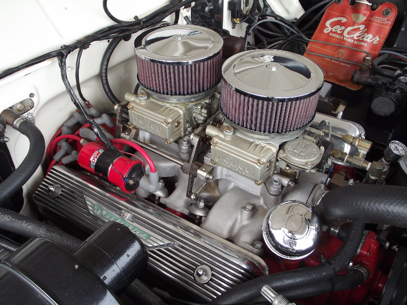

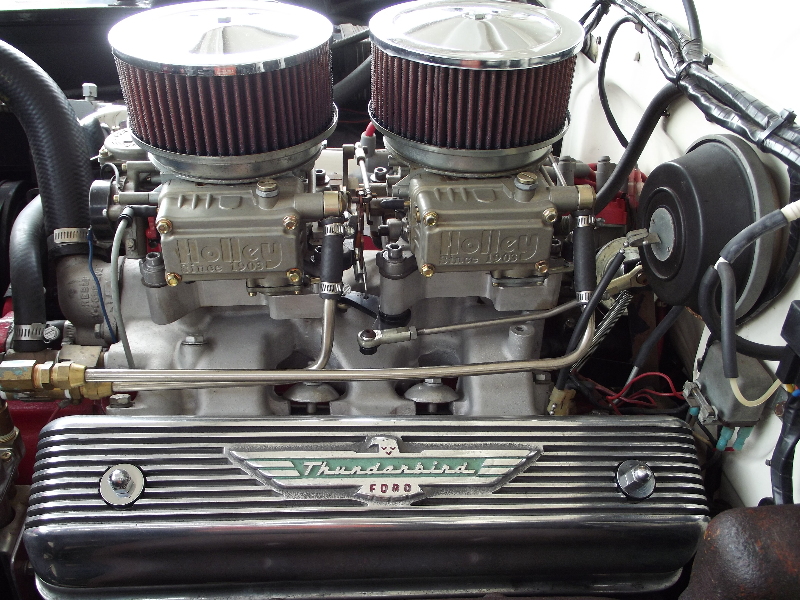

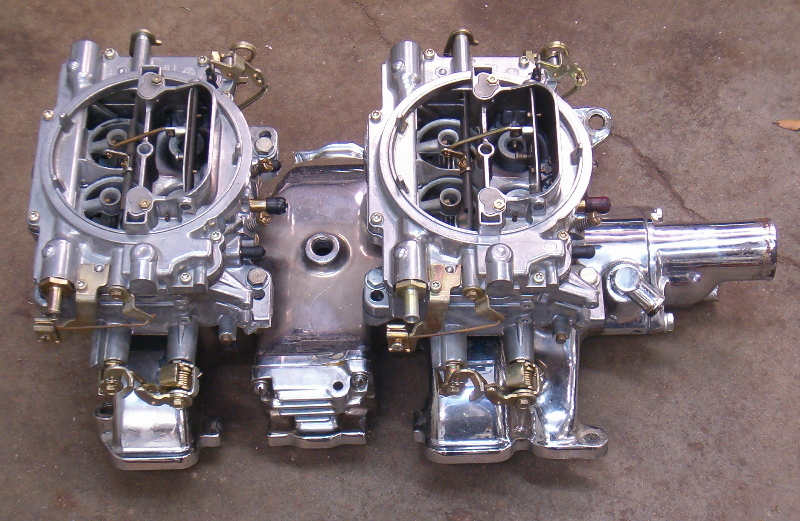

If forced into getting rid of the model 4000 Holleys (Teapots), then my vote for a simple carb change would be for the 500 cfm Edelbrock carbs with adapters under them.  The closeness of the carb pads on the factory dual quad intakes does makes carb choices limited.  A little imagination with some sideways mounted Holleys and appropriate linkages could have a pair of 390 cfm Holleys being used instead.

Here are some pics to help you along.
http://forums.y-blocksforever.com/uploads/images/97272bb3-7aae-4dae-b460-26eb.jpg
http://forums.y-blocksforever.com/uploads/images/622fb4e2-bae3-419a-b16d-8cac.jpg
