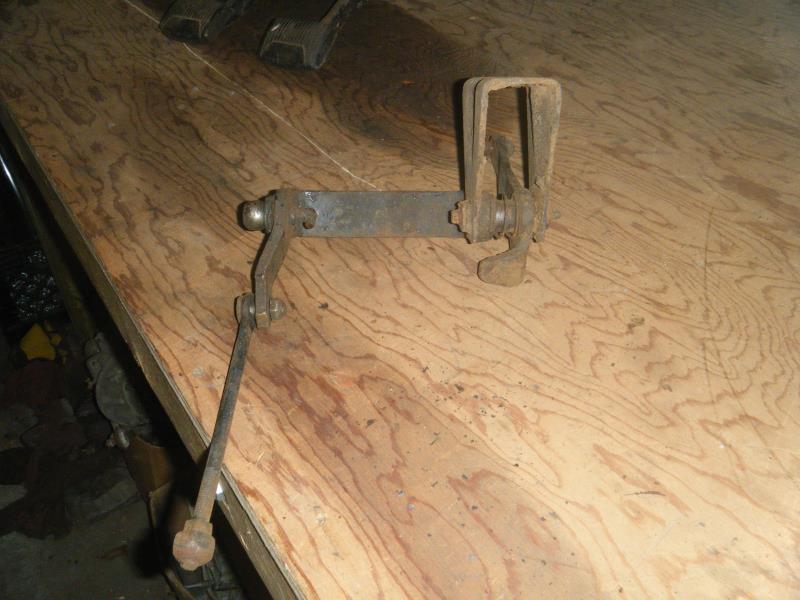

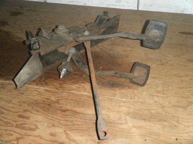

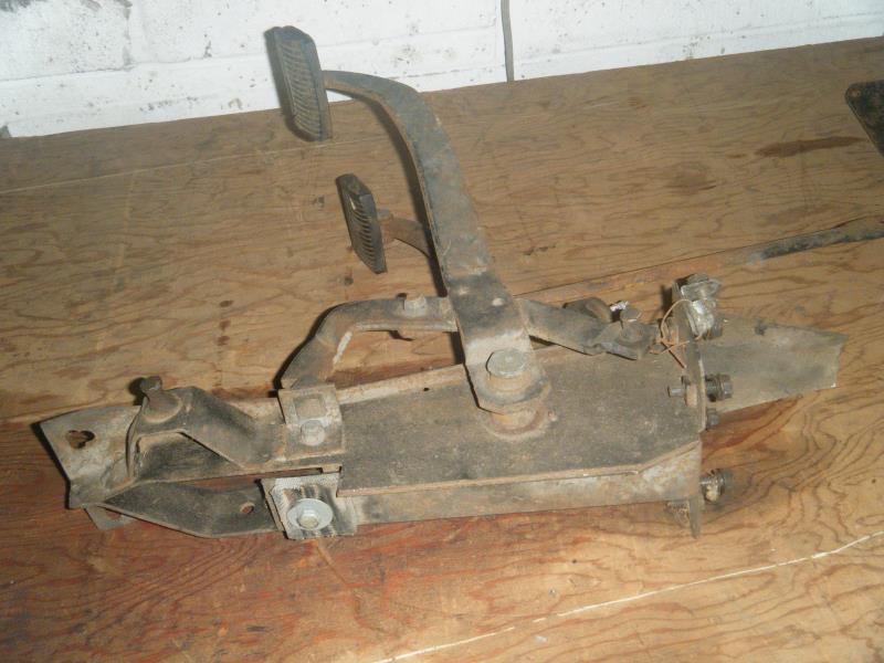

http://forums.y-blocksforever.com/uploads/images/b3f3c774-97f3-430d-8022-5e4d.jpghttp://forums.y-blocksforever.com/uploads/images/69485e71-2741-4427-a42c-3ead.jpgBird Shit !!!!!!!!!!!!!   Might have a few extra parts laying around if needed.  Oldmicshttp://forums.y-blocksforever.com/uploads/images/0511b6c6-a416-4502-8126-8a8a.jpg

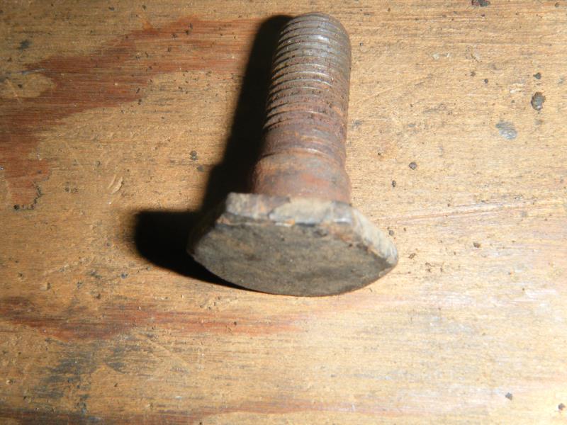

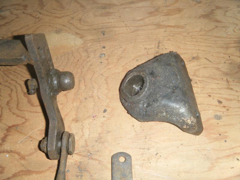

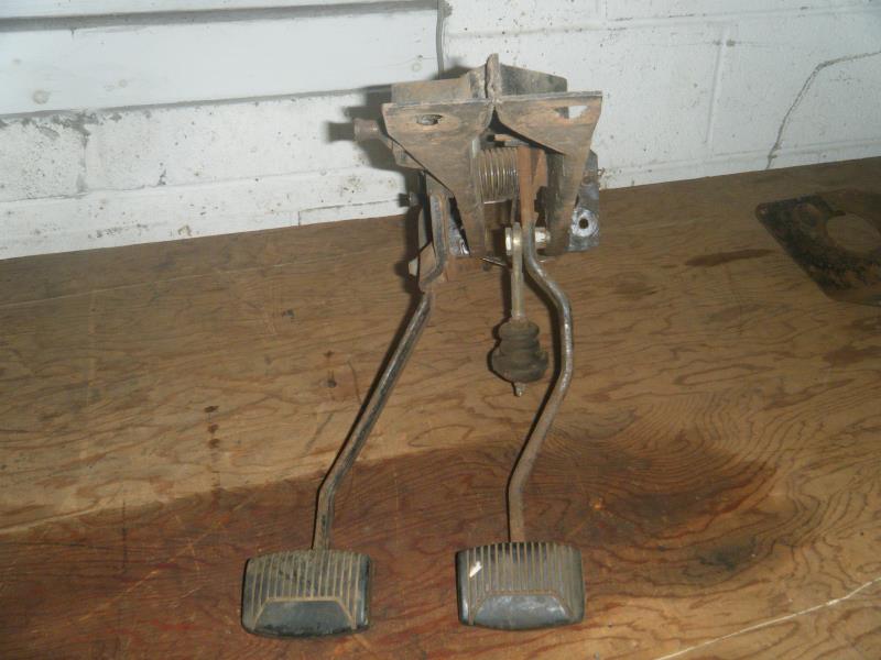

http://forums.y-blocksforever.com/uploads/images/ec69cbb1-3edb-47f6-93af-7ec8.jpghttp://forums.y-blocksforever.com/uploads/images/7ed5f9fa-bb08-4d78-a527-db2a.jpgMorehttp://forums.y-blocksforever.com/uploads/images/21257018-c7a2-49d3-98dd-a3d8.jpg

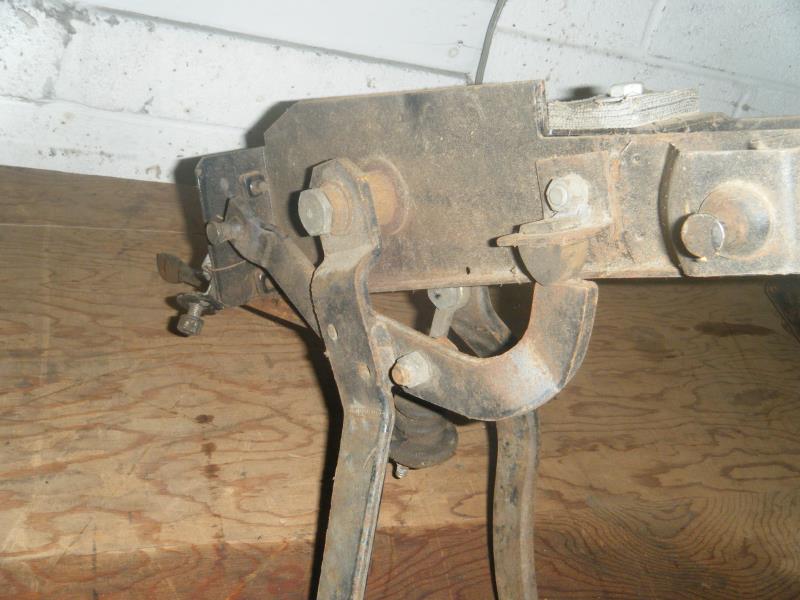

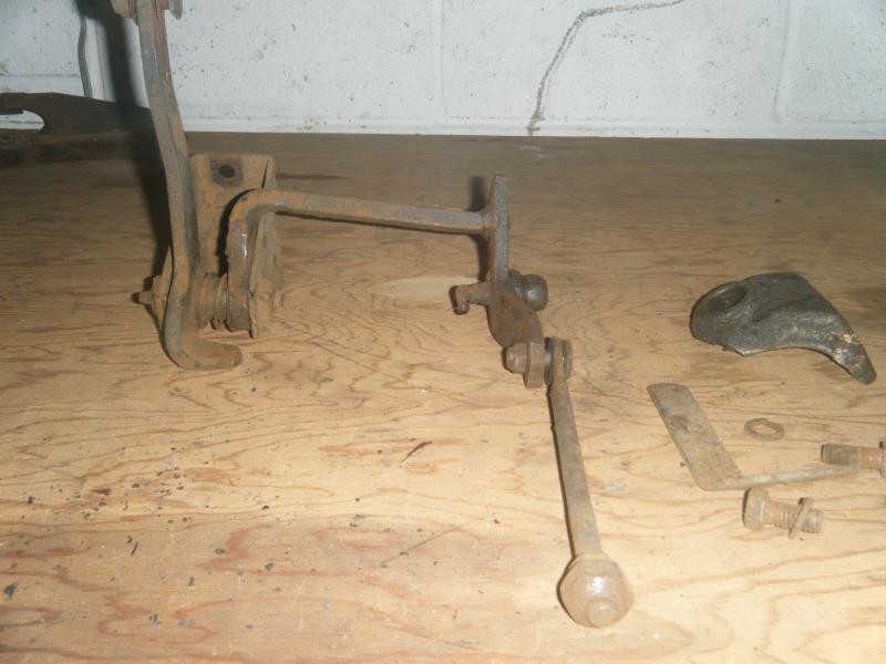

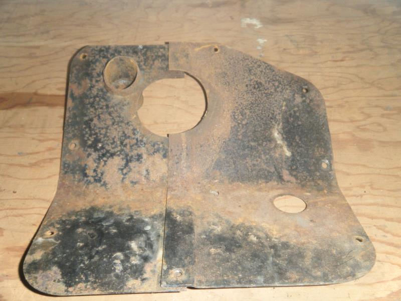

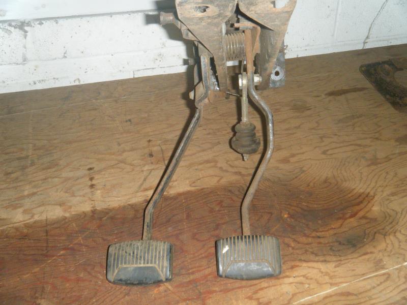

http://forums.y-blocksforever.com/uploads/images/90da2810-4a74-44e8-8970-69dd.jpghttp://forums.y-blocksforever.com/uploads/images/5363eed4-95cf-481d-a84d-d133.jpghttp://forums.y-blocksforever.com/uploads/images/47cfad65-182f-4d48-8242-7b15.jpgMore Againhttp://forums.y-blocksforever.com/uploads/images/5534df59-f5cf-4653-90b7-1b52.jpg

Old Mics,
Thanks so much for taking the time to dig the parts out and photo ,comparing to what I have it looks like I have everything. I am having issues with the rod connections at the bolts, the rods have a much larger hole and a flat spot on mine that don't match the shoulder bolts. I see they sell a square looking washer that rides on the side of the rod but what takes up the slack around the larger hole? Also I have a spring and Z shaped bracket with an adjusting bolt for the clutch assist, also appears to fit very loose with none keepers over a mushroom shaped pin sticking out side of pedal assembly. When attached per book view and pedal depressed the spring goes slack and then falls off. However its good to know I have mostly all the major parts on hand.

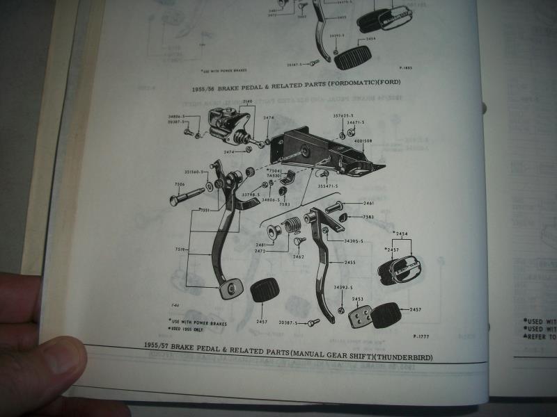

Posts: 3.7K, Visits: 32.5K

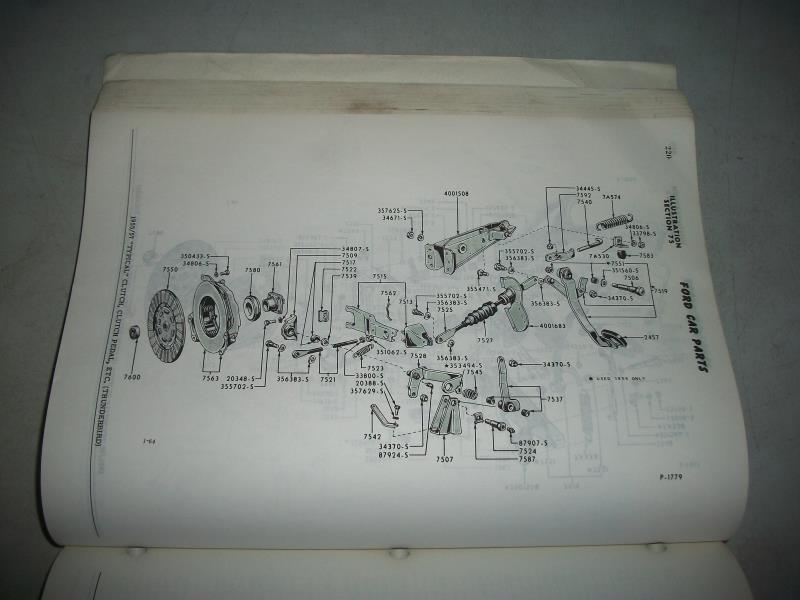

Couple of Pics from the Parts Catalog. May or may not be of help.http://forums.y-blocksforever.com/uploads/images/5de45298-2d8b-4cf6-9504-89c6.jpghttp://forums.y-blocksforever.com/uploads/images/c534fcde-4ea7-403f-976f-9c1d.jpg
Oldcarmark.  Oldmics' pictures were great.  Your suggestion of Gary using the '49-'59 Ford Illustrations Catalog as a reference guide is an excellent thought, too!   Smile

If you need clairification on those smaller parts, let me know exactly what you need to see and I can post that up.
Funny as I did not realize that I did not have the pedal return spring until I looked at the pictures. I'm sure its around here somewhere.
That's all off my 3 speed (no O.D. ) "E" Bird that I"m restoring.
