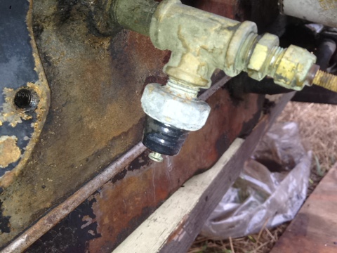

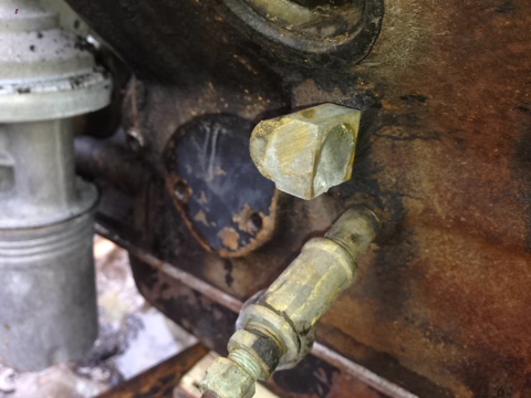

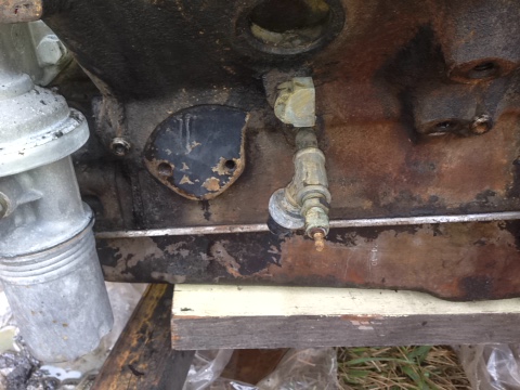

  Ok I can figure one is a pressure switch of some type, could be oil, I don't know enough about the
Y block yet to understand every hole.
    The one above it, 90 deg  is filled with some type of hard puddy

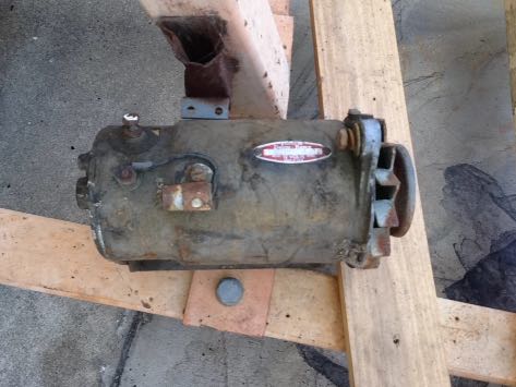

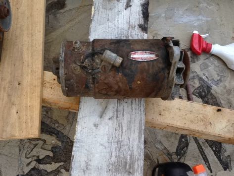

   Did Ford ever use a Delco Remy generator?
  I have 2 that been laying around my house for far to long and they are going, going and
but first
Model                                            Serial
1102003                                         5J30
1102022                                        5B23
just in case someone here knows anything about them and could use them...
I"m going to post them to CL...
and yes I know they are generator's  It's the brass fitting's I asking about

The top hole is the water drain hole.  Usually has a drain valve in it.  Looks like they did a hokey thing to plug it.  If you take it out it may still be plugged as dirt and rust sometimes builds up there.  Stick the hole with a screw driver and water will come out.
The switch certainly looks like the oil pressure sender.  Usually just screws into the block without all that other stuff.
Posts: 3.7K, Visits: 32.5K
Its an improvised Adapter to hook up a sender for the Light and a Line for an aftermarket Gauge. Usually the Sender for the Light screws directly into the Block
