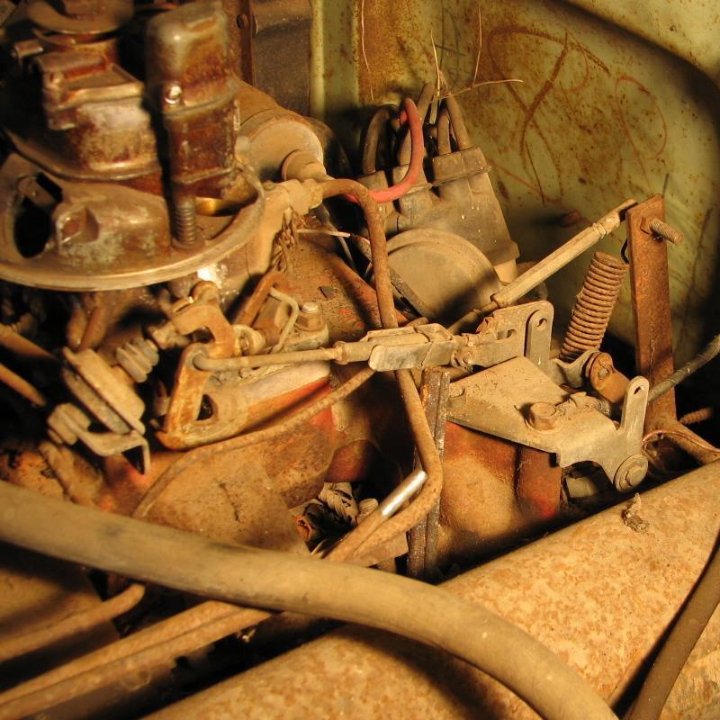

Here’s a picture of the linkage for a ’55 Ford S/W with the 182HP Special and Ford-O-Matic.  Not 1956 but should be similar.
http://forums.y-blocksforever.com/uploads/images/dbdff130-2560-40e4-bedf-4246.jpg

The linkage shown is unique to the 55 so the 56 is a lot different.Dont have a picture of the 56 but I am sure someone on this site does    Carl

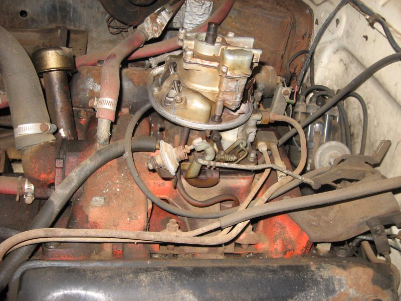

Good catch by Carl on the ’55 4V linkage being significantly different from the ’56 4V linkage.  With that in mind, I went searching thru some of my older pictures and found this picture of a 292 4V in a ’56 Town Sedan.  See if this helps.
http://forums.y-blocksforever.com/uploads/images/1c38a969-d283-4348-a1f4-3c63.jpg

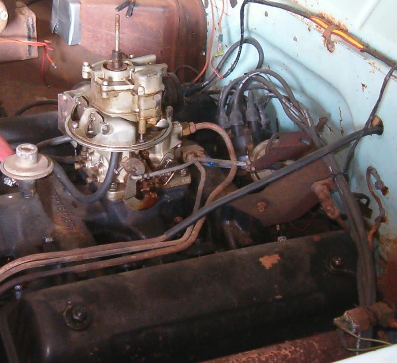

Kahuna, Pix is from a pretty original 56 292 4bbl with auto. If you need close ups of anything let me know.  - Bob
http://forums.y-blocksforever.com/uploads/images/a65c4b4b-fda7-4984-83cc-3ec5.jpg

Thanks everyone for the help.
I'm sure I can at least get it figured out now.
It sure appears to be a complicated mess, just to
move throttle blades & a kick-down. Oh well

One other thing on 55,56 linkage.The 55 can be used on a 56 but a 56 will not work on a 55.The reason is the 56 sits closer to the firewall than the 55.Ford changed the firewall on the 56 cars by putting a recess behind the linkage so it has more clearance than the 55.If you compare the 55 to a 56 firewall you can see the difference.Hope this makes sense  Carl
