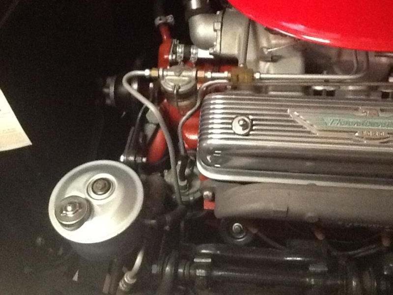

I'm not a believer in the sintered bronze style of filter - I'd rather have an "element" style that can be changed out. The AC GF62 unit is exactly the same mounting length as my original T-bird filter, uses the same mounting and inlet/outlet adapters - and the canister can be fitted with the FOMOCO/Motorcraft logo cans from the 60's.
http://forums.y-blocksforever.com/uploads/images/450da5d0-f5bb-4086-8389-d1b1.jpg http://forums.y-blocksforever.com/uploads/images/cb0aab98-0f8f-4f91-90b2-0e5e.jpg
The mounting boss of the AC filter housing can be drilled out and threaded to accept a pressure gage as well.
