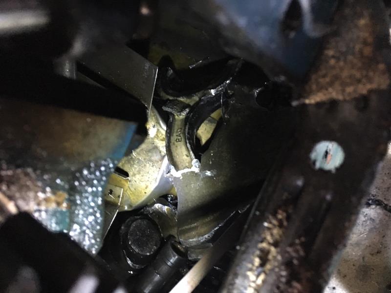

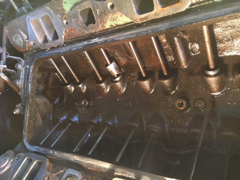

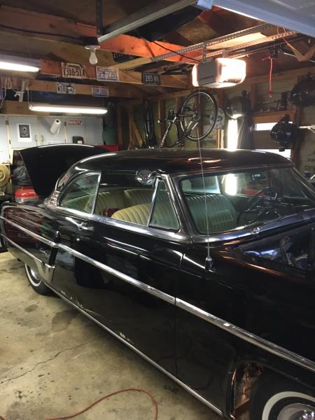

http://forums.y-blocksforever.com/uploads/images/b05ba407-4cc6-4dc6-ac75-f490.jpghttp://forums.y-blocksforever.com/uploads/images/e3d2ca84-ed8b-4c48-891f-3c7f.jpgHello everyone, I posted this thread on this n that and got no replies, so I figured I would try here as I am really desperate. My GF recently got a 54 Capri from her dad who owned it for 20 years. After getting some head work done by a jackleg mechanic, he drove it home where it grenaded. (See pics) Upon removing the front of the motor, I found a peice of the cam, bearings, pushrods, lifters and crankshat pieces. I havent got the block out yet, but am pretty sure it is garbage. What are my options? Will a 368 bolt up? I am having a difficult time finding  317 parts. Any help would bee much appreciated.http://forums.y-blocksforever.com/uploads/images/ddda3668-50af-497b-8873-0b61.jpg

368 should bolt right in. Its in the same family as the 279,302,317,332,341 and 368.  Theres a brand new 368 bare block on eBay for only $1000.00 plus shipping.
