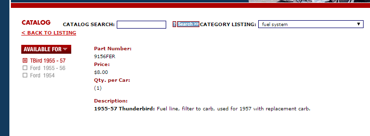

Have you looked at something like this, from Tee-Bird products?
If I understand what you are trying to do correctly (big if, Im not as knowledgeable on these engines as most on here), this may work for you.  However, you will have to also add the t-bird style fuel filter, and get a new line from the pump to the filter assy, and the mounting tab for the filter assy too.
Thats basically what I did on my 56 Sunliner, as I wanted a more modern carb but wanted it to appear as original/correct as possible.  Plus its hard to find replacement fuel pumps or rebuild kits with the filter bowl on them.

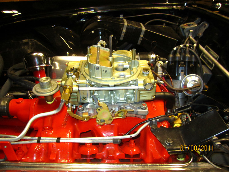

One of our members used this Holley 465 cfm on his T-bird - 4160 style with side hung bowls - and the hard lines look pretty good, but not stainless.

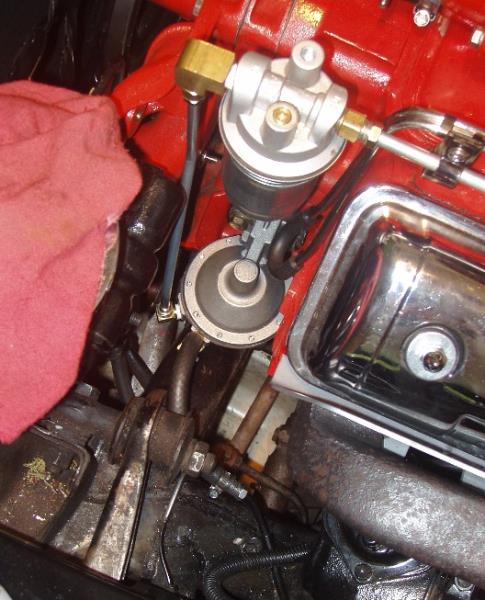

Mine has an older model Demon 525 - and I hard line plumbed it through a Delco fuel filter (GF62) ..... mounted in the location of the original T-bird glass bowl unit.
