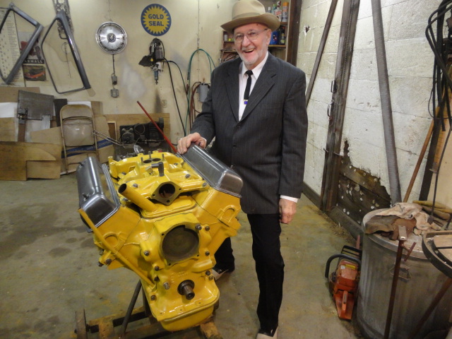

The picture shows the 'new' engine, all set to install when the old it taken out, this one is overhauled, new rings, valve job, new timing chain and rod bearings.  Total cost was a little over 200 bucks, it'll run like new.  I found a rod bearing set on eBay for $20.00, this helped cut costs, rings, gaskets & timing chain from Summit Racing (best price).   Having an extra engine around to overhaul saves a lot of time.
