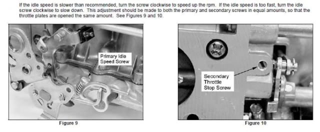

It sounds like you need to check a couple of things on that Holley.  It will require you to remove the carb and drain the fuel, and turn it over to check to see if the secondary throttle blades are open .020" showing on the idle circuit slot.  The idle on all Holleys except the four corner idle carbs should be controlled by the idle slot in the SECONDARY throttle bores.  Adjust them by the little screw on the secondary linkage to show .020", or by bending the linkage tab on the right rear corner of the base plate.  Then adjust the idle screws in until they gently bottom out, and back them out approximately 1 complete turn.  This should get the idle to settle down so you can fine tune it and set the idle speed with the accelerator arm adjusting screw.  Also, you should check the blades at wide open throttle (WOT) to see that they are 90* to the base plate, and adjust the linkage to accomplish.  Then lastly you need to check the accelerator pump for .015" clearance between the lever and linkage at WOT.  Should now idle in gear correctly.  Joe-JDC

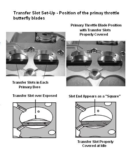

The comments above about the Holley carb - need some illustration. The primary blade has to be properly positioned on the "transfer slot" down inside the carb throat. Without this precaution, the engine will stumble badly and have a very poor transfer from idle to "run". You can best see that blade position - when the carb is off the engine and inverted.

It takes tremendous will power but - once it is set-up - it shouldn't be moved while trying to adjust the idle.......only the mixture screws. The amount of additional throttle to keep the engine running should come - as mentioned above - from the secondary side of the carb. Each of the secondary bores has a "dribble port" for lack of a better name, where fuel constantly bleeds out of the secondary bowl through a small orifice. There is a small screw on the bottom of the carb - just below the secondary pot - that will hold the secondary blades open a bit - add air - and provide idle air to the engine. It can only be seen when the carb is off the engine - and most 4 barrel manifolds have a clearance below it.
http://forums.y-blocksforever.com/uploads/images/ed3e2220-c040-4a9f-aefd-be92.jpg
Personally, I often replace the screw with a slightly longer bit of thread (cut off a longer screw) so something will protrude below - that I can grab with a needlenose plier to fine adjust. Otherwise, you are stuck with the previous advice - bending the throttle tab. I have seen some tuners replace the screw with a socket type set screw - and use an Allen wrench on it - but I don't have that kind of patience.
After setting the primary throttle to its initial position, turn the mixture screws to their starting spot. Install the carb, , fill the bowls with fuel, start the engine, and successively adjust the secondary blade with the stop screw to make it stay running. The choke needs to be "off" - so it is the first order of business after the engine runs a bit.
