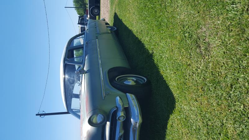

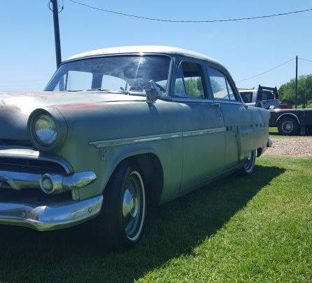

Just bought a 54 customline, just wondering how hard it is ,or if its worth reconditioning the ford o matic ,or just going c4
