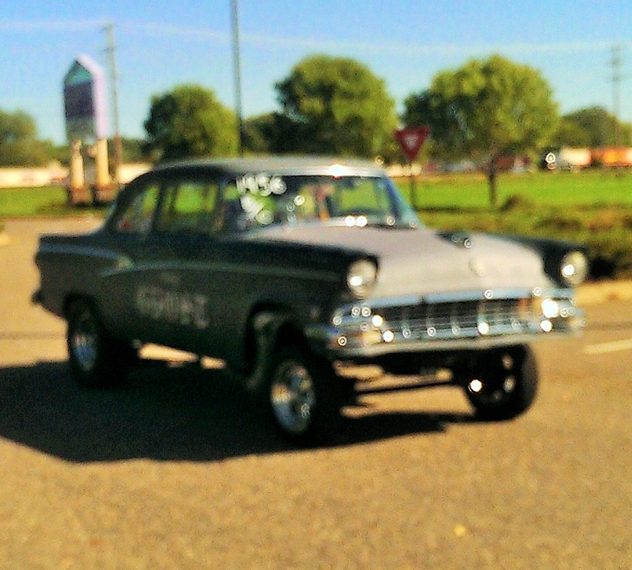

Hi Mike,
I am a Minnesota Y member also, (as well as SBF and FE). I also am in the early stages of a Y block build for my 56 customline gasser. I will be following your post with interest. Though I am a long ways from needing it,I wonder if any of the builders you mention have a torque plate for honing 292 cylinder bores.
thanks for posting,
Dean Markuson (DEANs427 on other Ford forums)
http://forums.y-blocksforever.com/uploads/images/90f116af-b3cf-4452-823a-a9e5.jpg
IMAG1470 (4).jpg (749 views, 216.00 KB)
