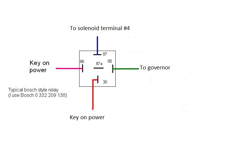

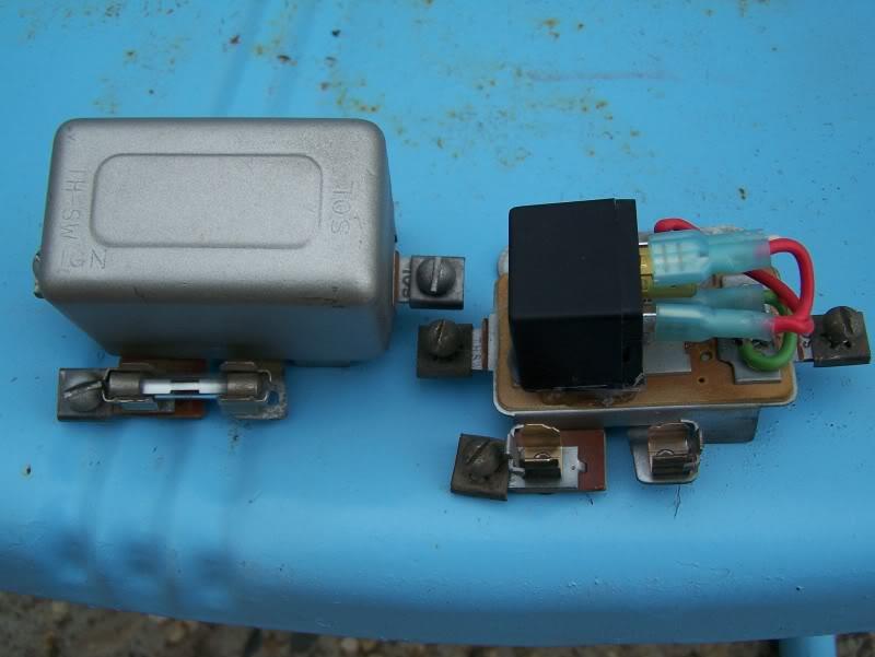

If you have the original relay just gut it and install a 6 volt headlight relay inside the original case. I did this for my 57 Ford which is of course 12 volt and used a heavy duty headlight relay from my local auto parts store. Think it cost me about 15 dollars , works great and looks original.
Step by step instructions with pictures can be found by doing a search on the HAMB.

A couple of pictureshttp://forums.y-blocksforever.com/uploads/images/b27321f6-211d-40cd-a478-8a63.jpghttp://forums.y-blocksforever.com/uploads/images/bc236562-8219-4b59-a53f-1ffe.jpg

You can do it for 6 volt as well, just use a 6 volt relay
