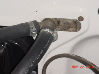

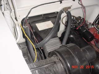

No, my car (55) has no air conditioning.  Car in family since new so this is the way it came. Also had a 56 292 with same valve.  Valve is cable operated and as Dan said it has a thermostatic coil to regulate the flow of hot water depending on where the cable lever is set.

Here are a couple of pics.  Hope these help. Ben
