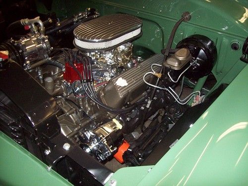

I can't help with the Power steering, but this is the cleanest Power Brake install ever and it's REALLY cheap
It's a 1985 Ford Mustang unit from a Pick & Pull, mounted on the firewall of a 1954 Ford. The later/bigger
engine is of no consequence. "Almost" a bolt in.
And, you get the dual chamber Master all in one. If you want to spend a few more bucks, you could replace the Master with one that reversed the outlet ports
How's That? All courtesy of Danny on the Hamb
