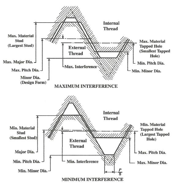

I may be wrong but I thought the interference thread was in the rocker arm not the adjuster? ... The interference thread design is in both the rocker arm and the adjuster. It takes a 7/16-20NF tap to clean up the interference threads in the ’57 and up rockers so that an early locknut style adjuster can be used. Here’s some technical information on the interference threads as there are different amounts of friction that can be built into the threads.
