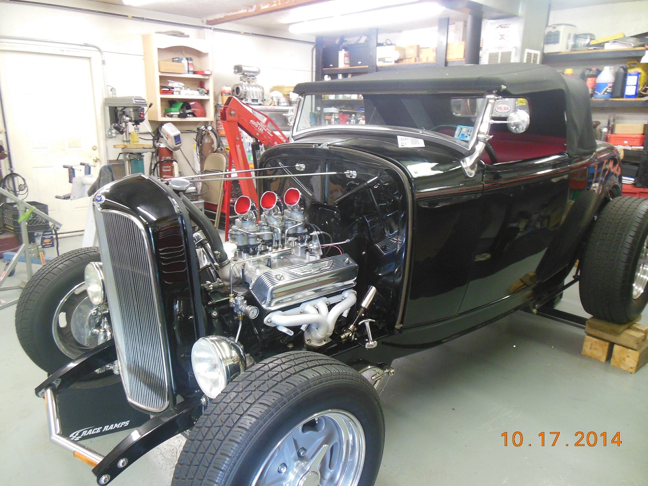

Finally finished my Yblock install in my 32 Ford.. Took longer than I had planed .Had to fab a lot of items..Still have some brackets to make , fine tune, cleanup some wiring and wire up the MSD 6A box.Run & sounds good.  Had out for ride last night and got lotsof looks & comments on it being a Ford Y 312..Very pleased with outcome..  THANKS to ALL on this site for info and guidance..Regards Steve McD        One picture attached and a closeup of engine already on this site on " Cams that fit  312"    Stuff that Fits listing..

Looks great.  What are the headers, custom??

I made the headers .   Started with a set of unwelded "Scrub" headers .  added about 3/4" to each of the center of outside tubes  and added  a small turn at bottom of each tube  before collector to clear frame .  would have liked to make them longer but too much stuff in way..  Object was to be able to put hood and sides on ..     Took more time than you would think  but I enjoy such projects..  engine sets low enough to install a 4-71 under hood in future ..I bought one of the "Y-Bloke "  intakes.....  That will be a challenge with clearance issues also...Until them Ill enjoy driving the car a lot.. Regards Steve McD

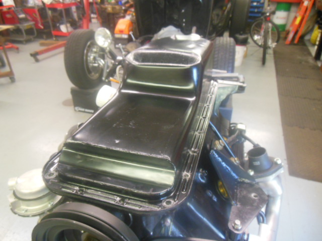

Steve, what are you using for an oil pan?

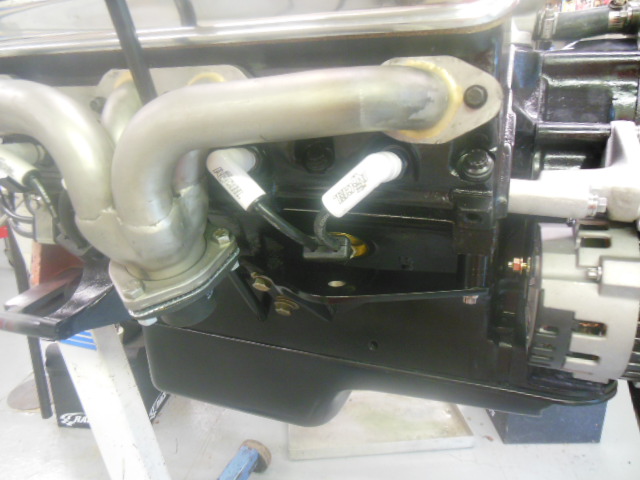

I used a T-Bird pan   but altered the front  with a piece of bent metal.  [Disregard the caved in pan bottom where my engine hoist flipped while moving]  I needed clearance for mini- rack & pinion...I tried a truck pan it will also work by cutting front as I did but you probably would have to install gates...  side view photo on next reply[ wont let me attach 2]..Regards  Steve McD

side view  of cutout for tie-rod    ...  also in pic is how I finish headers   I weld to flange from inside , then diegrind to match,  then bolt to an old head.and fill outside seam with brass  before coating or paint  ... [ I think it makes them look better  , just my opinion]..  also in pic is the extended engine mount...I flat spotted the block and drilled 3/8 NC  for 3rd bolt..i thought the two original bolts were too much of cantilevered ahead so headers would fit.. Regards  Steve McD [thundercat]
