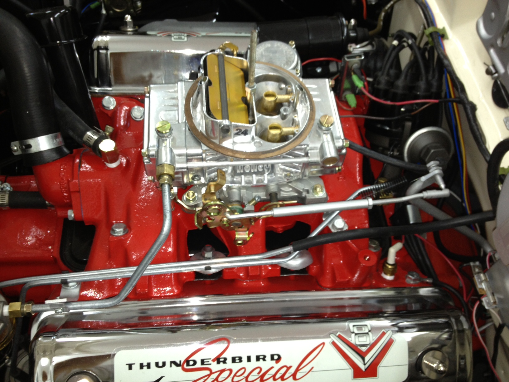

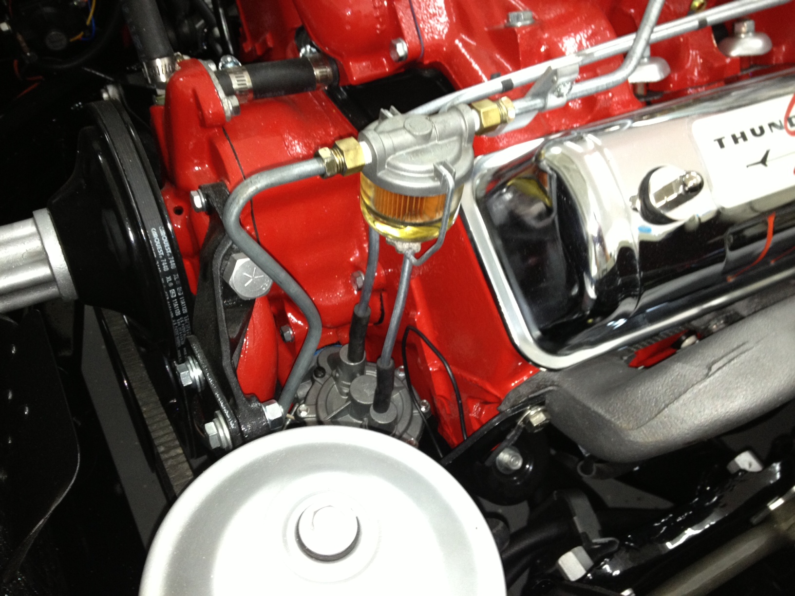

Does anyone have photos or could take some photos of how the vacuum lines run from fuel pump to the manifold and wiper motor on a 57 Y-block? I finally installed a B manifold on my 56 and those lines were hooked up differently with the teapot. I'd like to hook up everything correctly and make it look right at the same time.

A couple of pictures of my 57 Country Sedan 312. If you need additional let me know.

Thanks a lot Pete. This gives me a much better idea of how things need to look. Where did you get your vacuum lines?

Vacuum lines,clips, fuel lines and fuel filter are all from CASCO Thunderbird Parts.
