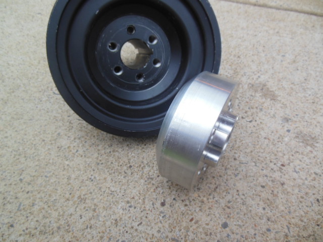

That's cleaner looking than the one he put on mine. Ditto on the quality. I found that the drive snout needed to be 9" long. I found a 7" and a 2" spacer. I can also provide information on the pulleys, I used 80mm to keep things a bit quieter.  Are you mounting accessory pulleys? I have some pictures of the crank pulley adapter I had made. Will be home late tomorrow and could put them up on Wednesday. Chuck

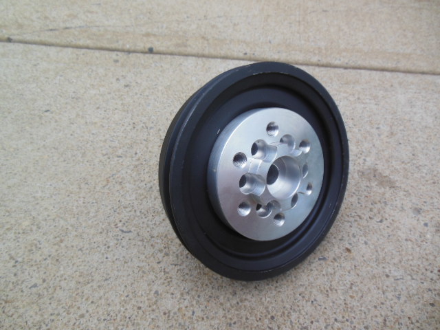

Ill try to upload pics of the drive adapter I had one of my friends make for me..  Its a Powerbond steel damper with 4 xtra holes drilled on bolt circle of existing pair of bolt holes  6 total with allen bolts  .made OD snug fit in damper . uses 2" pilot for pulley.  Currently have pulley for 2" Gilmer belt but might end up with a pair of V-belts.  ill make the pulleys.. Ihave very little room in front of engine.  Tranny too big to move /engine back any more without lots of work..  Steve McD

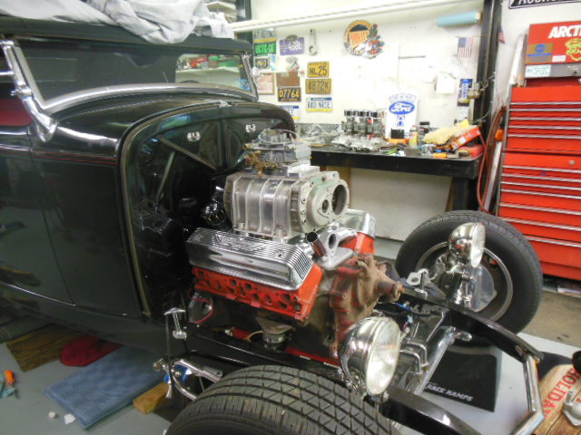

Heres the intake & blower mockup .  The blower project will be on  side shelf til I get headers made..  The blower is low enough for hood clearance and im trying to keep headers inside louvered hood sides..  Its tight fit ..  Short block parts were purchased with blower in mind.. I may assemble with hi comp heads  & 3x2s for this summer .Change heads in fall and the rest is already done.  Regards  Steve McD

Thanks for the pictures Steve. Great job. It will be an awesome ride when finished. I also like your motor mounts better that the ones I made up.

This is the adapter I made for my setup. Used a two V Y-block belt setup.
