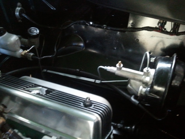

Here’s the link to a previously posted picture of the factory installed brake booster on a ’55 Ford station wagon.  All four wheels were power brake boosted.
http://forums.y-blocksforever.com/FindPost23011.aspx

Ted (5/10/2014)
Not a very good picture. I'd like to see a better one if possible. I have a Midland booster I'm planning to install.
