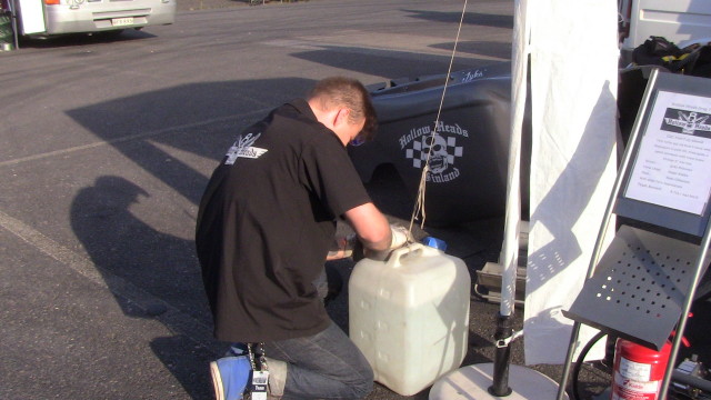

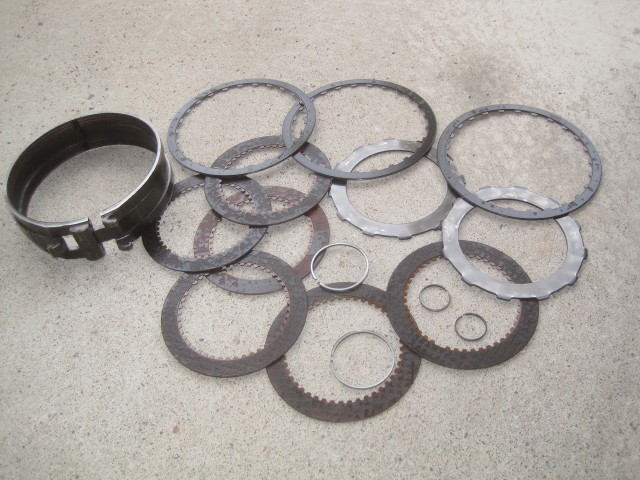

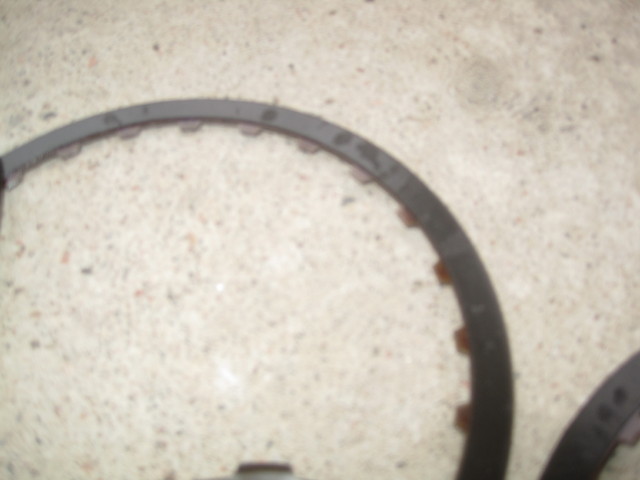

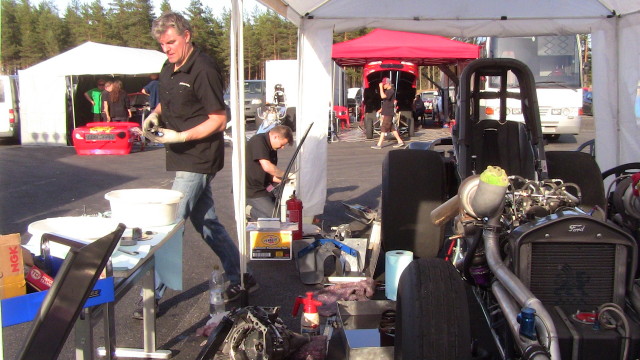

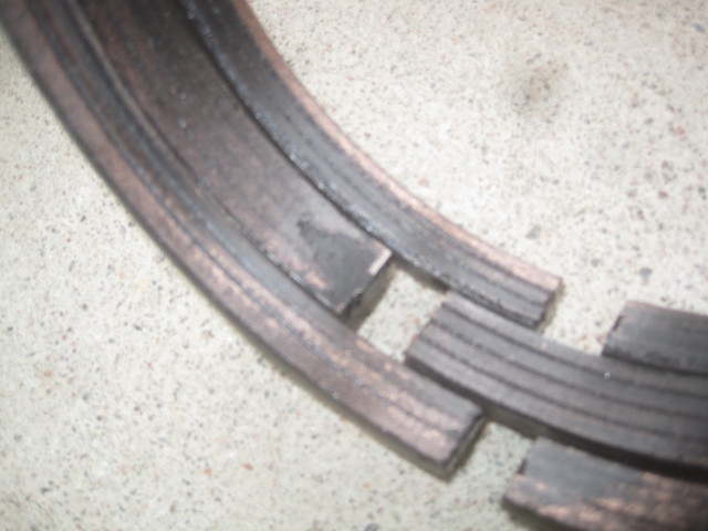

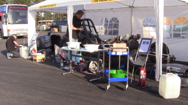

Last weekend was just another disaster Angry. Two runs and on the third we toasted the Powerglide! At burn out slot, when Jyrki hit the transbrake button, car jumped backwards. Front band was worn out, all friction plates were goodbye and also couple of small parts had to be changed. We opened up the tranny and put it back together at the pits with a help of a professional transmission guy. He added one friction plate and took couple of parts off from the tranny (speed secrets!) and now it should be better than ever! Sadly we could not test it as Sunday was full of rain. But, next thursday to sunday is next round of Finnish Drag Race series and then we go....FAST!!! The times? 9.2  and 9.3 with slipping tranny was all we could do...

He had the parts cause he knows that the racers are good customers during the race weekend. Smile
Kivinummi is one of the most respected automatic transmission guy in Finland so the tranny is fine now...although he's son is our opponent in the same class.Hehe
