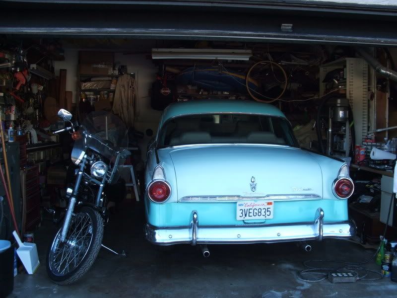

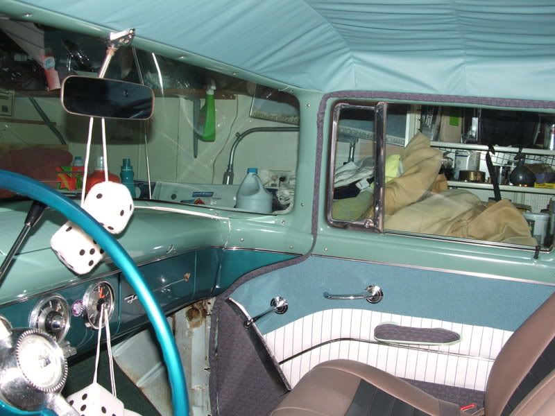

I got the headliner in without removing windshield or rear glass, there are wrinkles but not bad and was told it will tighten up in several weeks. Damn, that car is big...just put it in my garage and it is taking up way too much space. With my Corvette in there I can walk around and enjoy the extra space...and all along thought the Vet was bigger. Still have to the kick panels and sun visors, no biggie. Don't get sick when you see pictures of seats...they are only there so I can drive the car until I get around to upholstering the orginals.

Ron , two weeks or two years , those wrinkels will not come out by themselve ...You have the hard work all done ,  take a heat gun and pull those wrinkels out !!   or use a hair dryer .....just dont hold the dryer in one place ,   use a circler  movement , with one hand , and pull with the other hand  ....works for me //Luck   Sam
