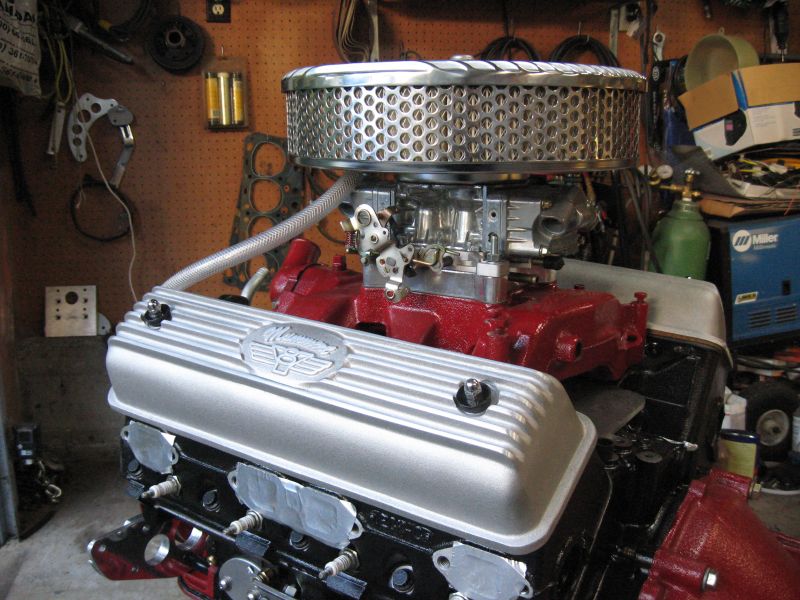

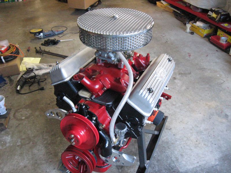

This looks tempting. I would like something for my brand new Mummert Script valve covers.
Mark
1956 Mercury M100
1955 Ford Fairlane Club Sedan
Delta, British Columbia
Mummert Script Valve Covers 002.JPG (369 views, 111.00 KB)
Mummert Script Valve Covers 003.JPG (356 views, 113.00 KB)
