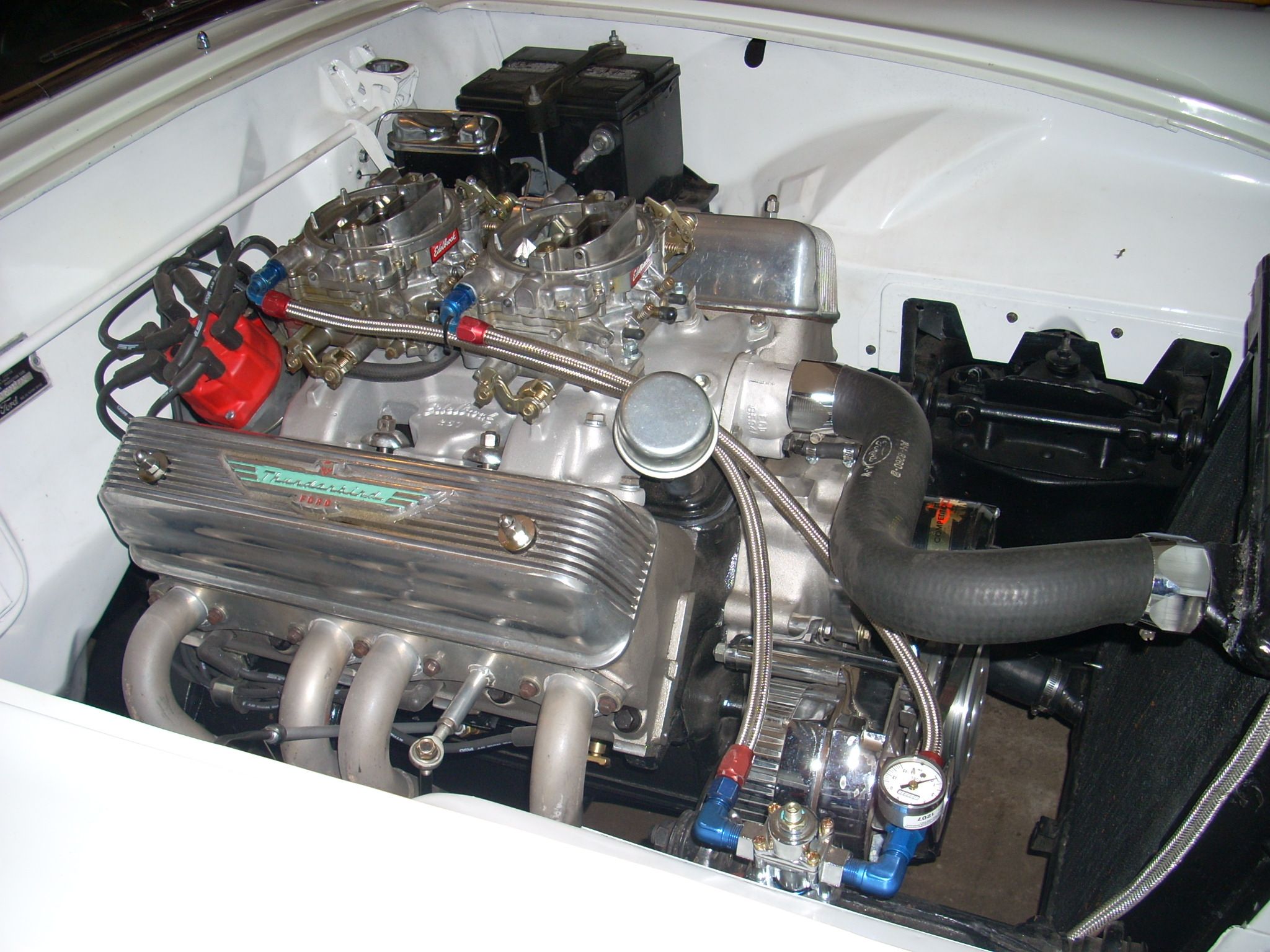

BOO- YA!!! http://www.y-blocksforever.com/forums/Uploads/Images/0f6c8c70-4f39-42e0-a021-bc5e.jpg
