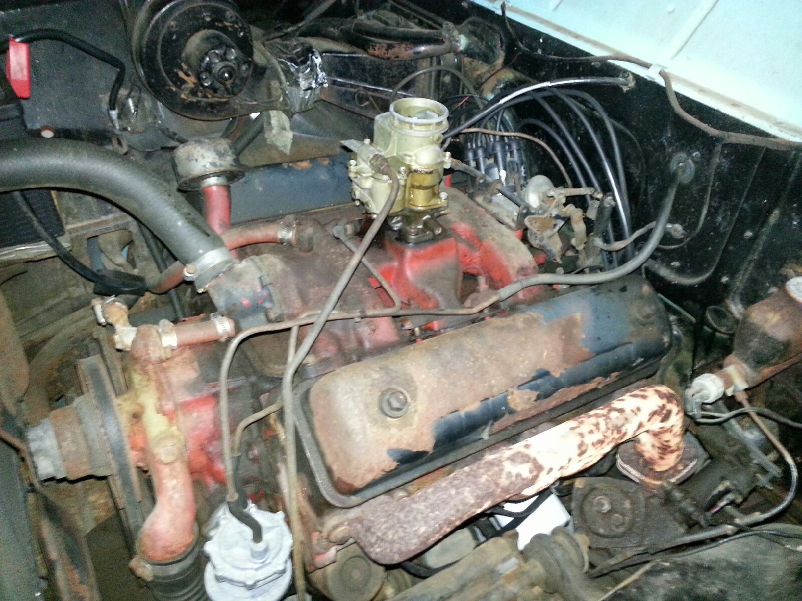

So here is what I could come up with given the little time I had.  (2 little ones).  It appears the intake manifold is not that of the 272 so not sure it that helps identify 292 vs 272.  The distributor is not stock as I attempted to buy stock points and cap that do not fit see pictures.  The manifold has a cast number on it that appears to point back to the 272.  I will attempt to get better information when I can get under the car, but this is what I have for now.

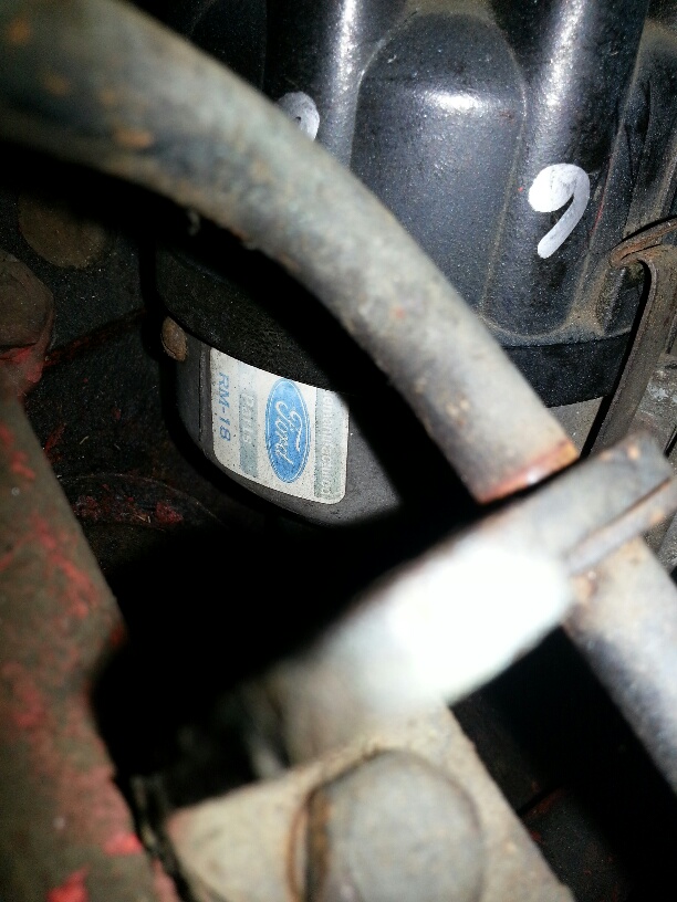

RM - 18 sticker on the distributor
On the manifold "firing order" 15986372 not sure if this has value
back of manifold has ECG9425 b under what looks like a side ways L, and below that a 1 with a dot under it.

As far as the points are concerned, there are two basic distributors. One is for 54 to 56. This distributor has a straight points base and the advance springs are on top the the plate in the distributor. 56 distributors have two diaphrams.
The 57 and later distributor has a curved points base and there are no advance springs showing above the plate (they are below). The cap is slightly larger that the 54-56 cap.
The distributor you have is probably a remanufactored one (hence the RM)
Usually, 272 and 292 manifolds were the same, even with the four bbl carbs so your 2bbl intake is probably the correct one for either engine.

Thanks for the info.  I think I am going to pull the RM distributor, and buy another one.  I will attempt to get under the car this weekend again to get the block number.  The manifold/headers appear to be that of the 292 as there is no cross pipe in the front of the engine.  Maybe I'll get lucky.  Updated my signature.  not to far from you.  Know any good machining shops assuming I want to got that route?

If you open the distributor top - and this is what you see -
This is the older model distributor (Load-O-Matic) - its NOT the one you want. Key here is that two springs are visible.
You would perfer to have a later version as shown below...
If you go to buy a remanufactured distributor at an auto parts store - ask for the part that fits a 1964 292 cid truck engine. It will have the vacuum and centrifugal advance mechanisms you want.
