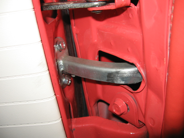

The Master Cylinder (10/7/2012)
Can someone tell me or post a picture of how the wires are routed into the doors for power windows. I am installing power windows and would like it to look some what original even though a ’55 Ranchwagon never had power windows (maybe a ’56 Parklane?).
The easiest looks like down by the lower hinge but is that where it originally was routed?
Thanks.
You need or could make this curved channel that supports the wires through the piller. Once you have these, align with door frame and drill hole, adding rubber grommet to protect wires. Hope this helps. regards bill.Smile

aussiebill (10/10/2012)
yyy
Bill, Excellent. Now I see how it is/was routed. My door jamb has the indentation but is not cut out, nor is the hole in the door. Makes alot of sense now that I see a picture. I'm assuming the curved channel is metal? I don't imagine the channel will be easy to find so I will attempt to fab one but at least you set me straight.
