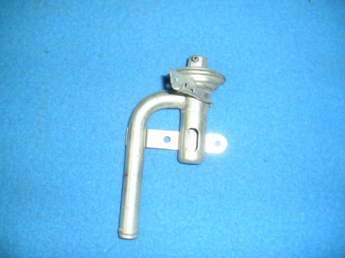

Here's a pic of the control. On the back side of the short straight pipe is a vertical opening that mates with the heater core. The longer extension goes through the firewall and mates to the heater hose. A 180* bent tube with appropriate opening, brazed to the core, ought to do the trick. Or so it seems...

The fitting in the front of the intake is pipe thread. You could screw a regular sink type shut off valve in the hole and adjust the hot water flow with that. Chuck

This trick is used by several oufits - CASCO for instance has a T-bird version - to simply change the cable control over to directly run the flow control valve. The hardware used is a valve from a 60's /70's (maybe earlier) pickup and in some instances a longer length of cable would be required.
Just for grins I looked up a '65 International Scout on the "RockAuto" site - a 5/8 x 5/8 straight valve, a 3/4 x 3/4 straight valve and a 5/8 x 3/8 pipe 90° valve came up.
I also found a thread on the HAMB where one of the guys was doing this to his '56 Ford sedan.

A cable operated flow control valve is used on the old Broncos, or at least there is one on my 1970 Bronco.  I replaced it a few years back with a new one I got at Napa.  Just might fit the older cars too.
