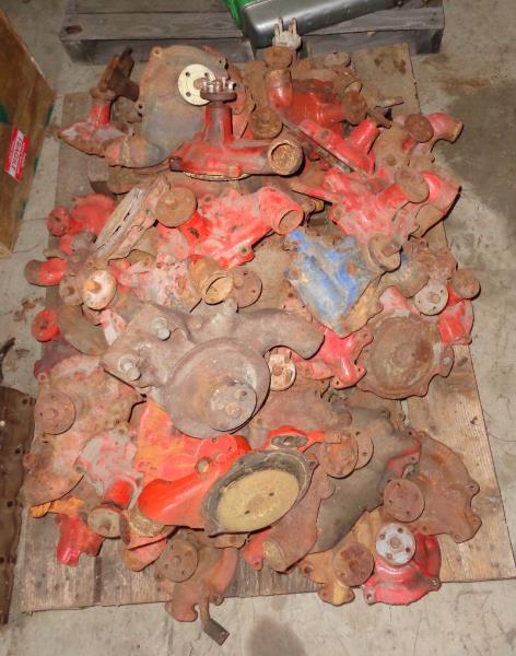

Be aware that the pickup/truck water pumps with the fan mount extension were supplied for both the 1954 and 1955 & up timing covers.  As such, there are two different pump sizes with the fan mounting bosses when it comes to fitting the different years of timing covers; small bolt pattern and large.  Here’s a picture of just one pallet of Y-Block water pumps that’s sitting in the core building here.
http://forums.y-blocksforever.com/uploads/images/b1fdd31c-bc0f-46b3-8deb-bdbe.jpg
