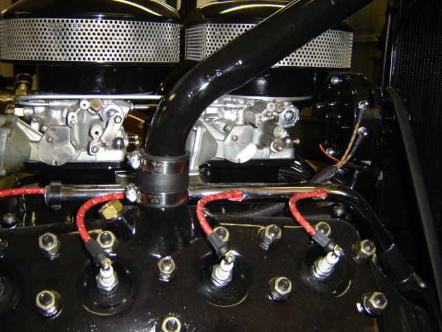

Also, Pat, I'd love more info on the secondary jet downsizing and what size dril you ended up using? I did add a balance tube for the secondary vacuum.
Jim

I had to solder the longer secondary jet up and redrill them, as they are too large for a dual quad application.   I think I used the stock figures, 55 for a dual quad car when I redrilled them, as the secondary air and fuel track on seems to be the same on a e-code carb and a '56 ford carb.
I still recommend getting an Edelbrock fuel ratio meter, PN EDL-6593 $139.95, from Summit, so you can figure out wha tis really happening when you make changes.   I have mine on a plug in harness and mounted in velcro, so I can remove when I don't need it.   All it takes is the included O2 sensor mounted in one of the exhaust pipes.
