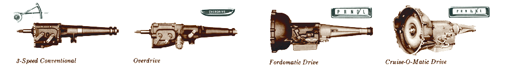

While I have all of this knowledge here... BigGrin
When performing this FMX upgrade, the shift pattern goes from D-L to the more familiar D-2-1 (FMX SELECT SHIFT) correct? In 1958 when FORD redesigned the FOM Single Range to the CRUISE-O-MATIC Dual Range (FX), there is a problem with the shift linkage/indicator, (number of detents). FORD also retained the FOM at least for that model year (1958) (1959 had the F/M/2 introduced) (I do not have MPC cataloging to discover last model year use on Single Range FOM). So would it be possible/plausible to find a 58 FORD with the D2-D1-L Dual Range (Green Dot) shift pattern and use it's linkage and shift indicator? The indicator would not be correct (different shift patterns) but it would give a clean changeover and not have to modify the origional detent.
Also, when one uses the FMX case for the conversion, the modulator valve deletes the need for the mechanical TV linkage needed until the introduction of the modulator valve in 1961.
At least this will allow a cleaner installation in a 57/58 (IMO). Has anyone attempted this?
Sorry to HI-JACK the thread but as long as all you guys are already here...
Trans Types-1958.gif (387 views, 31.00 KB)

KULTULZ:
I have an FMX in my '57 Ranchero.  For everyday driving, being able to select manual 1st did not seem to be an issue for me.  There are detents inside the transmission which locates the valve body spool correctly for each position selected.  I adjusted the linkage so that the P, R, N, and D detents on the column matched the detents in the trans.  After all this, I found that my column shifter had some wear in the top bushing, and when I shifted it all the way down, the shift tube raised up enough to allow the trans to go into manual 1st.  I still don't shift to manual 1st anyway.  The trans takes off in 1st with the gear selector in the D position anyway.  Inside the trans, in automatic 1st a sprag holds the planet gear cage, in manual 1st the rear band holds the planets.
John

I was told "there is enough travel to reach LO if the linkage adjustment is tweaked that way".  So we'll see what happens.
