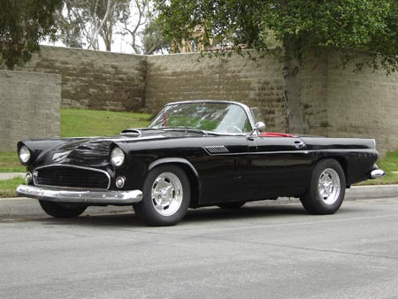

I am working on a similar project. My grandmother purchased my '56 in '58 and put about 25k miles on it. In '71 the car was parked in the garage and not driven again until '98 when she passed away. We went through the brakes, fuel system (inc. new tank), battery, cooling (inc. new rad from Larry's) and the hoses and belts. The car was willed to my father and he wanted to make sure it would be safe to move from the garage to a storage garage. After that, he could not decide what to do with it and sold it to me a few months ago. With the few repairs made to the car it was perfectly driveable and seemed perfectly safe.
After sitting for so long you can bet that the brakes need work. I have been driving mine on the rebuilt 9 years ago originals since I took possesion of the car. I live in very flat terrain and they seem to work fine (but I rarely get the car going much faster than 50mph). I have purchased the disc brake conversion from MPB and will install in the next month when my wife takes maternity leave (so I have her car to run for parts). I am replacing the ball joints, bushings and painting the control arms at the same time. I have heard that the BJ's in 'birds are built tough and don't really need replacement unless damaged. Had I not already purchased new ones from Larry's I would probably not be doing them. The bushings are another story. Shocks were replaced with KYB gas-adjust and 7/8" sway bars added front and rear. Those mods along with radial tires made a dramatic difference.

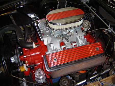

Under the hood, I started by adding a pertronix II ignition. That just went back in the box after adding an MSD (beware, no tach drive for bird owners), a Blue Thunder mani. and a 525 Demon carb. After reading many posts about the 390 holley and how well it works on Y's, I really wish I would have gone with it. I am still tweaking the Demon and the MSD to get rid of an off idle flat spot, but I had never owned a Demon and wanted to try something new. Along with the large radiator installed in '98, I put on a 7-blade fan and a new airtex water pump. I have diven this car all over and cannot get it to come close to overheating.
So, to make a long story longer, those things, some chrome, polished aluminum and an interior are about all I have done to the car. I would feel perfectly safe letting my drive it anywhere around town (fwy speeds after the disc brakes).

M S, that's a nice looking bird! The front end looks so much cleaner without the bumper donuts.

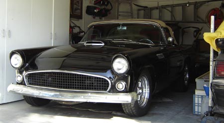

If you like it w/o the bumper guards, wait until you see the grill. It might have been a horrible thing to do to a sharp original un-replated grill, but I took out every other vertical grill bar out. Now it has more of a Ferrari-ish looking egg crate. I will post pics when I get it back in.
