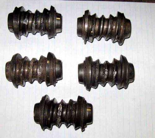

Hi, i cant see any problems with o.hauling your steering box, the parts are readily available from a few suppliers, joblot,concours, etc as others have pointed out. Finding a good used 54 box that hasnt allready got the case hardening  worn from the steering worm may take forever and a lot of wasted $. The worm would wear through the case hardening in the center straight ahead position then the teeth would get chips in it causing freeplay, over the years  pressure on this point by constant adjustment would make it worse and can cause chunks to breakaway and lock the steering from returning, panic!! The worm is pressed onto the shaft and has 1 keyway locking it in position. I suggest get a good mechanic with steering box expeirence, pay for the necessary parts yourself then pay him for his services. They changed the 2 tooth roller sector  in 56 to 3 roller sector shaft and while the worms look similar do not mesh correctly. Ford in 57 changed to the recirculating worm and ball steering that is still in use today and is far more efficiant, less efffort to turn and wears alot better.  Hope this helps, regards Aussie Bill.
