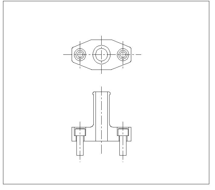

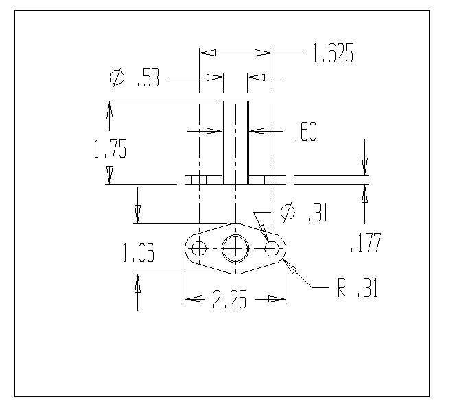

If you have to make one.....
WATERPUMP BYPASS FITTING.JPG (160 views, 31.00 KB)
WATERPUMP BYPASS FITTING ALJPG.JPG (141 views, 24.00 KB)

Thanks paul, yes that is what I am after, I have not seen it on Johns website any idea of a part number at all, much appreciated, Regards

Are you referring to the bypass hose piece at the rear of the water pump? If so, John Mummert in CA, has aluminum or stainless one for about $14.50

I have asked this before I know, but have not come across any to date, does anyone know where you can buy a alloy coolant bypass adaptor?????? If they are available I would buy one, If not I will make one.
