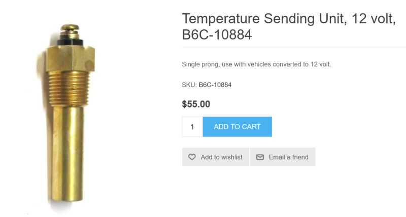

I bought a Repro Temp sending Unit From Dennis Carpenter. B6C-10884-A. Not keeping constant setting. Has anyone else had a problem with One of His senders? I would have preferred NOS but impossible to find. Thanks!

I bought one a couple of years ago and had the same issue. No reading and then suddenly it would come good. I think the issue is that it is a B6C 10884 without the A on the end. I suspect that it is fine for a light but no good for a gauge. They do come up NOS on Ebay occassionally. I bought one to replace that unit and also bought a spare about a week ago. There's one there now but it's very expensive.

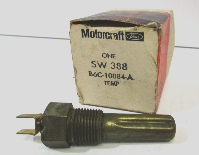

"I bought one a couple of years ago and had the same issue. No reading and then suddenly it would come good. I think the issue is that it is a B6C 10884 without the A on the end."
Many vendors use partial FORD PN's to make one think the part is GENUINE FORD. They can only show/use a partial PN as to copyright liability. The correct FORD P&A PART NUMBER is B6C 10884-A

I would much rather have an original NOS one but virtually impossible to find at reasonable Price. I find a lot of repro electrical Items DON'T work as originals did.
