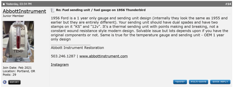

http://forums.y-blocksforever.com/uploads/images/062c007d-4549-465a-8875-9acd.png
