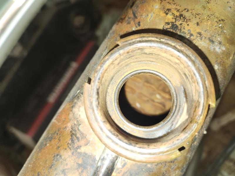

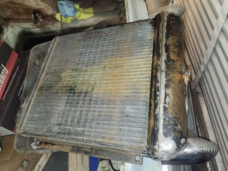

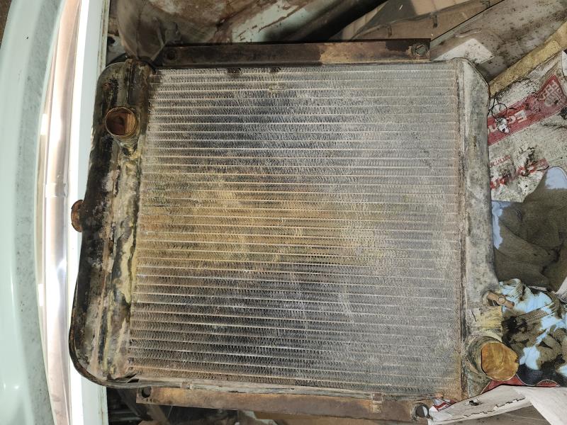

The radiator I took outta my 54 Capri is fairly ok. I cleaned it out with rust remover and I believe there's a leak. Called radiaror shops around here, southeast AZ. Nobody wanted the responsibility of fixing it. Now I'm looking into an aluminum replacement. I found a few with similar measurements that look like they'll work, but thought I'd ask all you experts what they recommend. And please don't suggest $500 custom made jobs.
Also, are electric fans an option?
