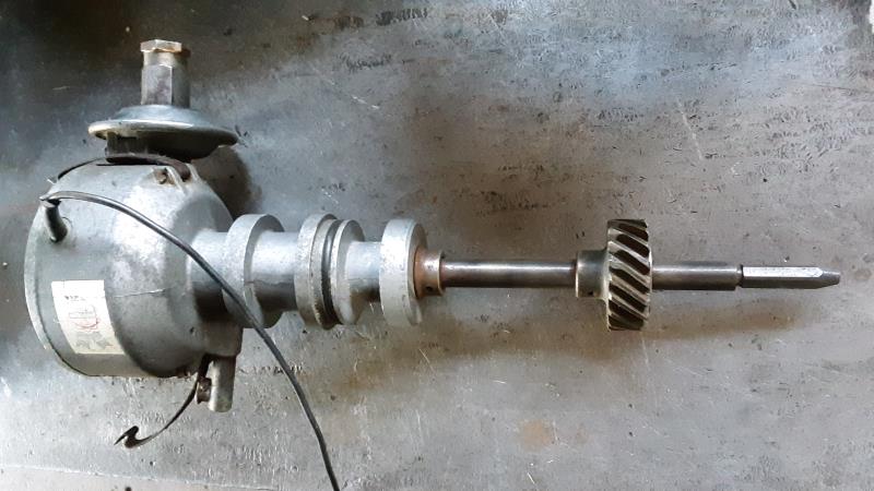

This is an oddball heavy duty distributor that apparently fits the 292 HD larger F series commercial trucks. It has a male tang on the bottom of the shaft for the oil pump drive , a larger distributor gear and the body of the distributor where it registers in the block is larger than the passenger car distributors .

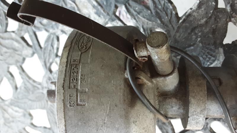

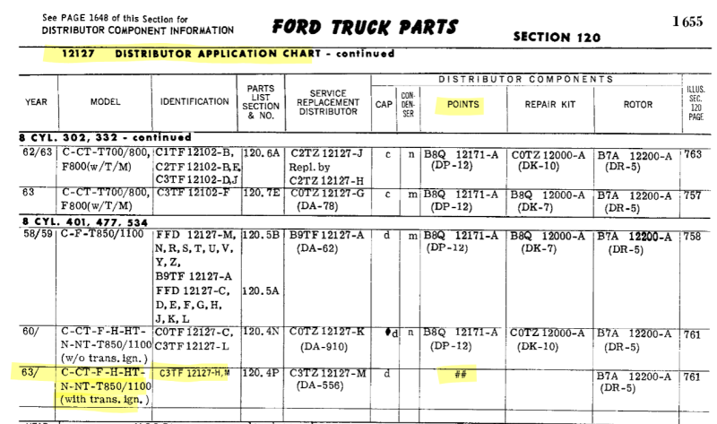

The posted page from the truck MPC shows this distributor will fit only the 401, 477 and 534 cid hd truck engines and not a Ford Y-block.  I'll try to post a couple pics of the one from my parts/core box. It is truly an addball distributor....
64F100 57FAIRLANE500
FORD DEARBORN
Posted 2 Months Ago
Last Active: 3 Weeks Ago
Posts: 852, Visits: 113.5K
http://forums.y-blocksforever.com/uploads/images/8799d78d-408c-44b2-8a8a-9bb2.jpghttp://forums.y-blocksforever.com/uploads/images/943ff8c6-d1e9-4f2d-87c7-7887.jpg
