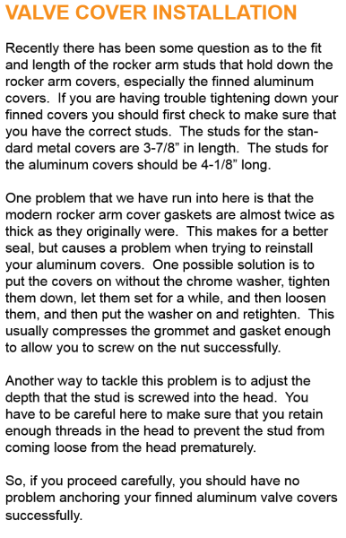

NOTE: if you install the Thunderbird valve covers, you will find that your studs for the Ford sheet metal covers are way too short. Even after installing the correct studs, I had a small problem with fitment.

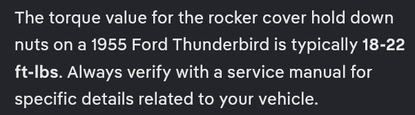

There is a TORQUE VALUE on the retaining nuts.

I have the "correct" Studs but like You I find they are still shorter than they should be. Have to back the One at back out several Turns and then re-lock the retaining Nut on top of Stand.

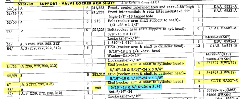

If the replacement gasket used (in place of OEM cork) is thicker, naturally the stud may not be as tall as needed to allow the acorn nut to contact enough threads to hold torque value. You may need to increase the length of the stud(s).
I would also apply BLUE LOCTITE to the threads of the studs to hopefully prevent the nuts from backing off. A lot of tension with the improved thicker gasket.
Also, if the studs are not torqued to value to the cyl heads, they will most likely vibrate and loosen negating the nut set torque value.
The TORQUE VALUE will be in your WSM.

Studs don't get torqued with the same spec. you might get away with in on lower torque values but it could be problematic. ARP recommends a bit past hand tight. some thread locker isn't a bad idea for the stud into head. Unless its a race application or something weird i wouldn't put thread locker on the nut as that will more than likely pull the stud then your fighting to loosen the nut from a removed stud. set the valve cover bolts and check them after driving and then at increasing intervals until you see its not loosening as gasket settles in.

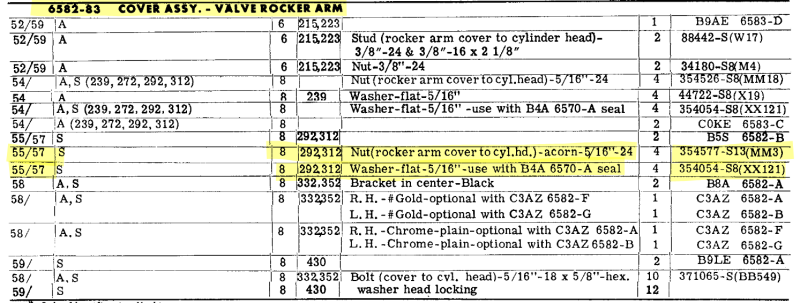

You installed the gasket using pretty much the same  way I do it. I use the acorn nuts for the hold down.  Basically, I just tighten by hand (no torque wrench) until I feel enough pressure on the wrench.   No leaks.  I suggest you follow the torque recommendation from Ford, but that is pretty hard to do with wing nuts..
I do torque the nuts that hold the studs to the head.  I don't know if Ford used lock washersunder those nuts, ,but I do.

Thanks Paul. I am going to try and be a little more inline with Your suggestions about tightening retainers mine being Wing Nuts. The Parts Catalog says Flat Washers and Lock Washer on each Location on rocker Shaft Supports. I realize that the Gaskets are thicker Today but I wish One of the Parts Sellers would start providing longer Studs to use with the Aluminum T-Bird Covers.
