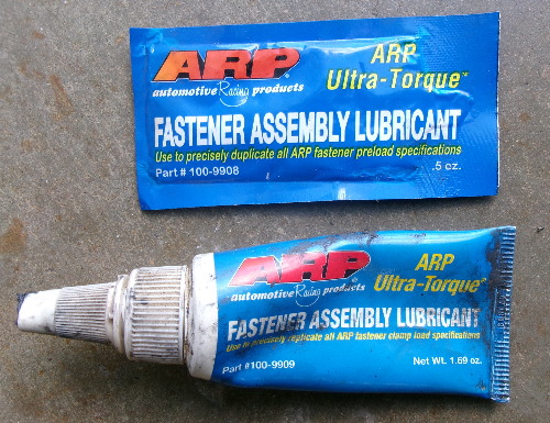

I was hoping you would respond Ted. Thank You. The Bolts are correct Length when checked against original Bolts. Purchased from Headbolts.com. Thanks for correct Information. Especially about no Lube on underside of Washers. What is the Head Bolt Lube u suggest?

  .. What is the Head Bolt Lube u suggest?
Because I use a large number of ARP bolts and most of the sets I order include the lube, I use the ARP bolt lube.  Using engine oil on the threads does make a difference; the same torque but less clamp load on the gasket.  Whatever you do, be consistent.
http://forums.y-blocksforever.com/uploads/images/6b88b503-23bd-4126-980a-3807.jpg
