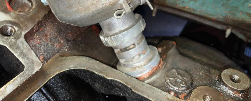

I'm trying to fully seat a freshly rebuilt 57 distributor into 57 y-block 292 engine block all stock.  It's been in before prior to rebuild.  Can't get it to seat the final 1/8", pretty sure it's not engaging onto 1/4" hex oil pump shaft.  Can't figure out a way to stop oil pump shaft from sagging down and preventing distributor shaft from catching.  I already turned crankshaft both ways while pushing down on rotor shaft.  I wonder if a swab of grease will hold oil shaft in place.  Any ideas, other than dropping oil pan?
http://forums.y-blocksforever.com/uploads/images/5e7110c1-09a0-451f-8ff4-dff1.jpg

Dick.  You said the distributor was recently rebuilt.  Was the lower distributor gear removed when that rebuild took place and if so, was the gear put back on in the correct location?  There is a measurement specification for that.  Being too low would keep the distributor from seating at the top of the block.
By design, the oil pump drive shaft has a washer on it located just above the oil pump and that washer is to help keep the shaft in place when the distributor is not in the engine.  The oil drive shaft has a pointed end and that should be pointing towards the top of the engine when installed.  The chamfer or point on that shaft will help to guide it into the distributor as the distributor is lowered into place.  There is a similar chamfer on the bottom of the distributor.  It’s not unusual to have to rotate the engine forward and/or backwards to facilitate aligning the distributor with the oil pump drive.

I beat the challenge last night.  I was about to drop the oil pump and attack it from below, but decided to fight it from above one more time.  I gave it 3 more tries and it slipped in easily on the last try.  I was literally just about to give up.  I had set TDC compression/power on crank, and dist rotor ended up pointing to #3 cylinder.  I don't care, I don't want to take it out again.
I did remove the gear, but installed it in same orientation.  I wish I had a borescope to look at intermediate shaft and check if washer is present, but I been spending too much money lately to justify it.  If it's missing then I was lucky the chamfer was big enough to allow engagement.  If it's present, I wonder how good of a job it actually does on the centering.
Anyway, thanks for help.  The important thing is I'm still having fun.  Now I can jump onto next thing.

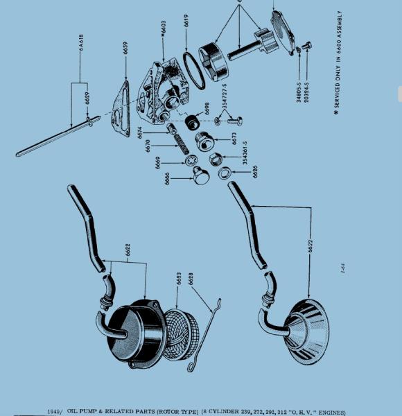

The washer is there to keep the shaft from pulling out when you pull the distributor. It goes in the oil pump before assembly.http://forums.y-blocksforever.com/uploads/images/fd3762f1-2ba1-428c-a17c-e7a9.jpg
