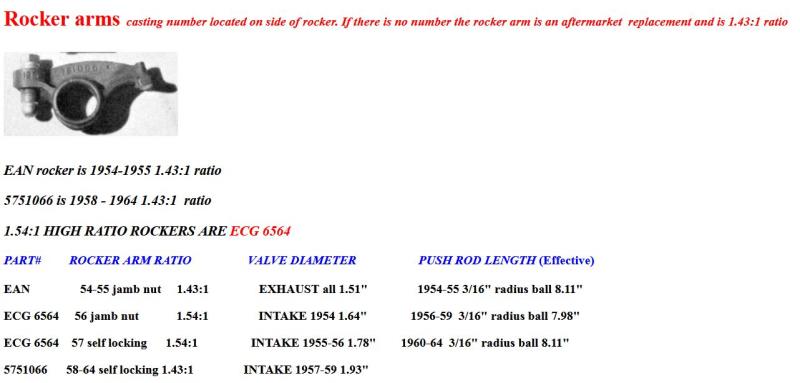

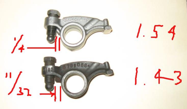

These are the numbers  on the rockers  for factory rocker arms.
EAN - 54 /55  1.43
ECG 6564 56 and 57 1.54  ((56 jam nut, 57 self locking)
5751066 58-64 1.43
The ones you have most likely are aftermarket or a Ford replacement, most likely the  1.43  The difference in the two is the gap between the adjuster and the casting... 1.54 is 1/4 inch, the 1.43 11/32
This is from info i got from ford-y-block.com (Mummert)

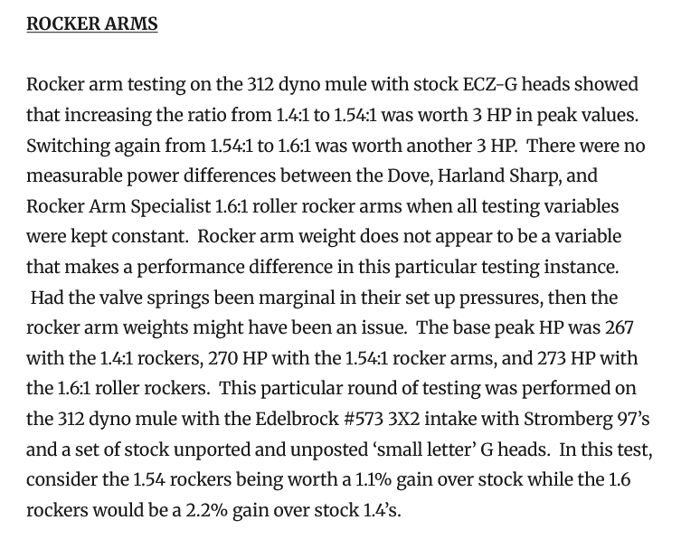

http://forums.y-blocksforever.com/uploads/images/6044cc90-1f90-4970-852a-9023.jpg
http://forums.y-blocksforever.com/uploads/images/d4691e21-ac6b-48cb-8604-1e3e.jpg

What you and Paul posted is simpler, if they are OEM rockers. In my case, I have aftermarket 1.6-ratio rockers from Rocker Arms Unlimited.

KULTULZ (4/9/2026)[
I don't question those results for that particular engine, but camshaft choice, heads (ported vs. non-ported vs. aluminum), etc.could return different results.
