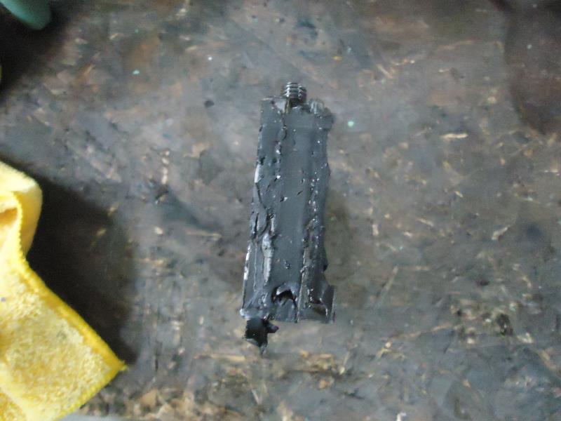

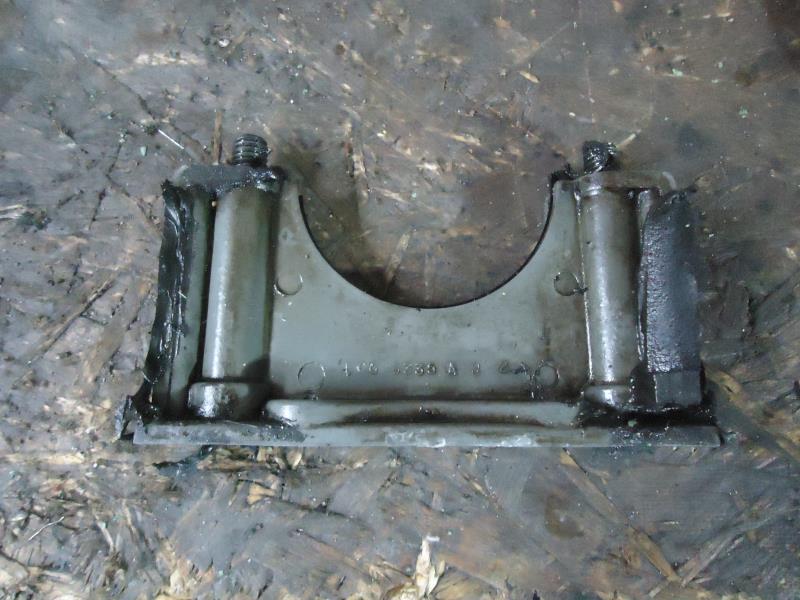

When I pulled the Engine just after I  purchased the Car 7 Years ago I replaced the Rear Main Seal because Someone else tried using wrong Seal. I tried something that a couple of People suggested. Instead of using the original type Side Seals I used "The Right Stuff"  to fill the sides and loosened the retainer a litlle so some would get under the retainer. I have to tell You it worked well. No Leaks. And that "Right Stuff" really is durable. Trying to get the Retainer off now and having a Fight to do so. It will flex but not break loose. Have to use a knife and cut away at the side Gap. Anyway I will do the same fix when I re-assemble it. NO indication of Leak at all. I have been told that many of the rear Main leaks on Y Block are NOT the Seal itself but Side Seals.. This Fix seems to work well. Here is a Picture of Seal Retainer shows how "The Right Stuff" works as a replacement for Side Seals. This would not come off after the Bolts were removed. Continued to flex and adhere until I sliced through with a sharpened Putty Knife. No way for Oil to leak past this Seal. I will do same when I re-Assemble my Project.http://forums.y-blocksforever.com/uploads/images/0f70875a-0e68-46df-8037-c3ea.jpghttp://forums.y-blocksforever.com/uploads/images/f5f4ce9b-230a-4d82-b0d9-52a7.jpg

I recently installed a rear main seal kit from Prestige Thunderbird.   They supply Permatex Grey to eliminate the side seals as you have done.  I haven't run the car yet to see how it works...................

That's interesting that Someone would supply the "Right Stuff" instead of Side Seals. I really believe that most of the Leaks are NOT from the Crankshaft Seal but from the Side Seals. Not a great design in my opinion. Last Time I left the Cap a little loose to allow the Sealant to get to the mating Surface. This Time I will apply a small amount before installing the Cap to make sure the mating surfaces get sealed as an extra precaution against Leaks. I think the difference in Black and Grey is drying Time maybe?
