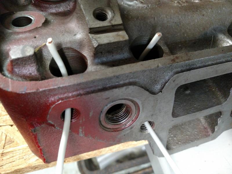

http://forums.y-blocksforever.com/uploads/images/3cff209f-15fb-4763-ac53-76f5.jpg

thanks Kultulz interesting .. not sure how that would get oil into the intake didnt look like any leakage from bolt head to port .. thanks Fred
