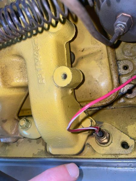

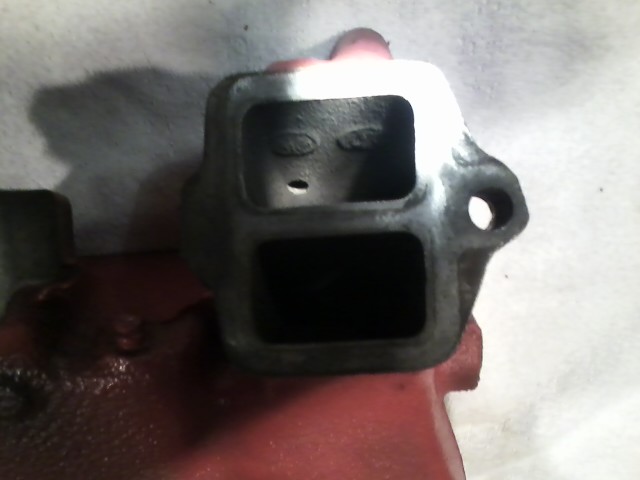

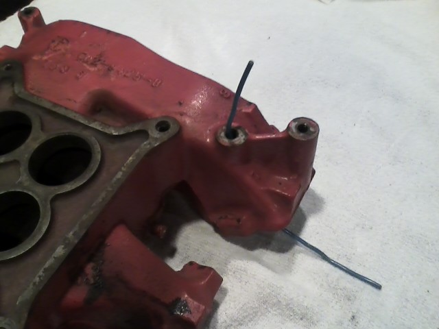

"55  272  with a problem of #8 cylinder pumping out enough oil to run out the manifold to exhaust flange   I have made a few changes and honestly dont know if either has affected the problem  and dont recall which came first.  I installed a 4 barrell set up with a t pot carb , at the same time removed the valley pan and built a baffle and hole to install a pcv ..."
You overhauled the engine and used a 55 or 56 4V INTAKE. There can be problems at #8 at the cyl head and intake mount.
At the coolant temp switch opening, there are two bolt holes as shown in the above illustration. If these are not used or blocked off, oil will run out of them hitting the valley pan and then running down the rear of the engine. Or could be sucked into a port with a poor seal.
Are you sure this is not what is happening?
